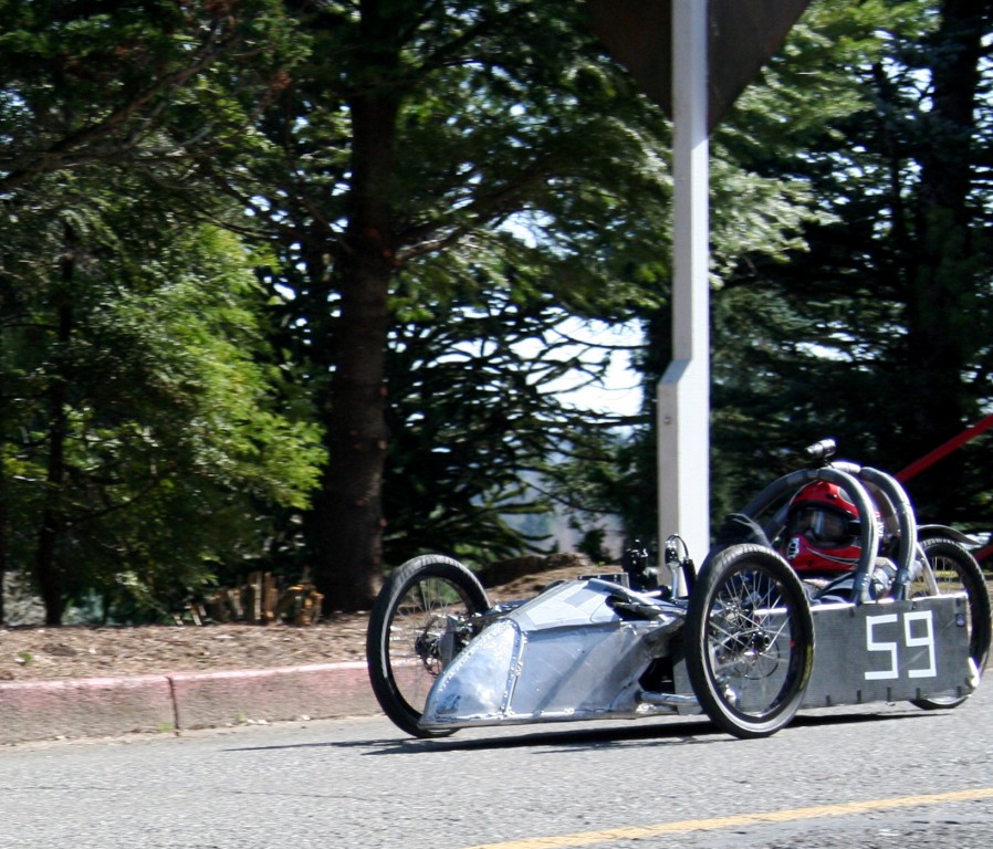

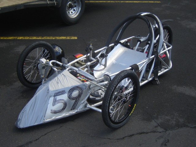

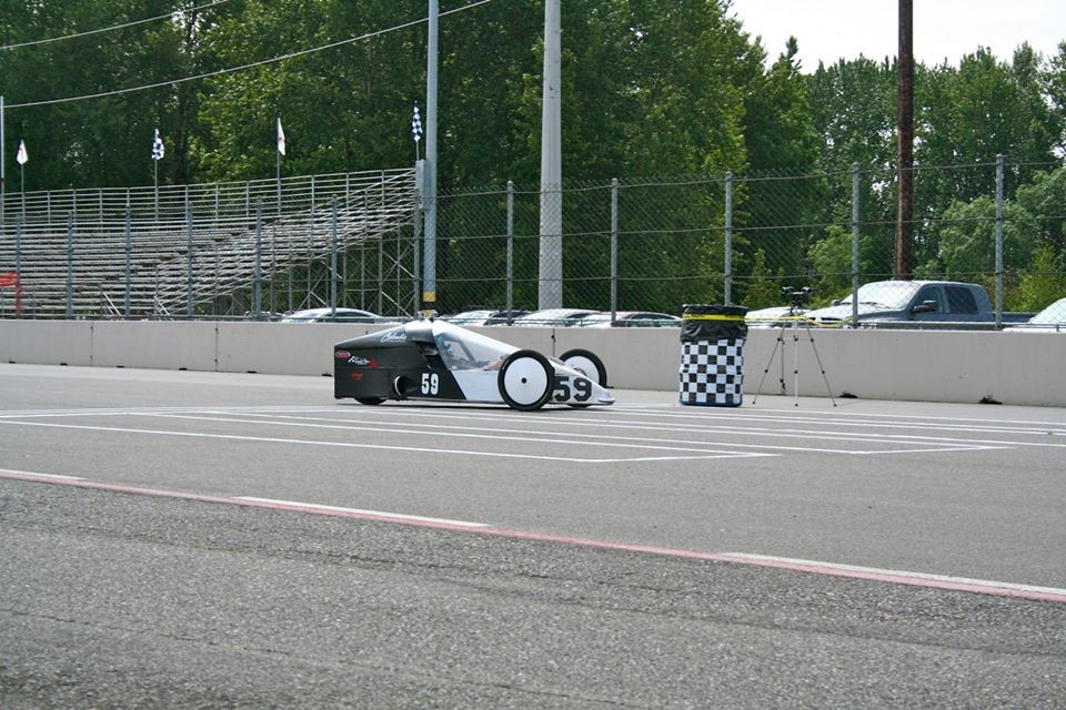

This is the first car Zaine Stapleton built for his senior year at David Douglas. Car #59 has raced at one race so far; the Eugene Celebration Kilowatt Klassic. The goal with his car is to get David Douglas interested in kick starting the electrathon program again before he leaves. The Intergrated Systems class at David Douglas has one car so far, car #55; the goal, build another before the racing season starts up again for the 2010 races.
Congratulations! I can tell by the way you drove it in Eugene that it will be a top competitor.

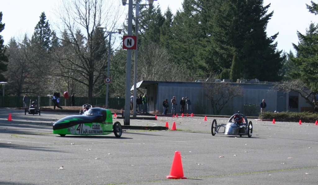

First electrathon event happened last weekend at Mount Hood Community College. Both David Douglas cars finished in the top 10. #55 driven by Kenneth got 10th, #59 driven by me, I got 2nd in the student class. Yay!

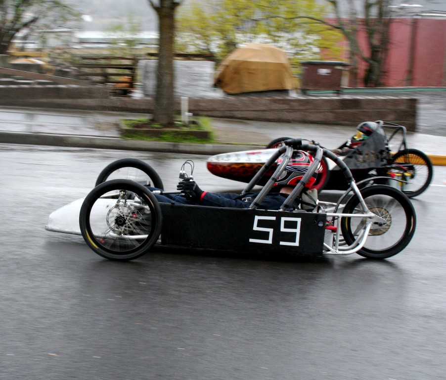

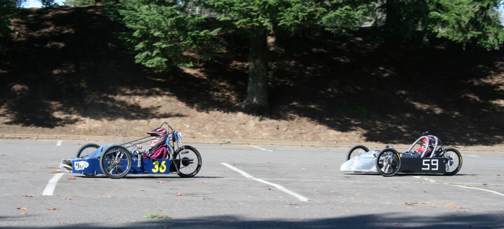

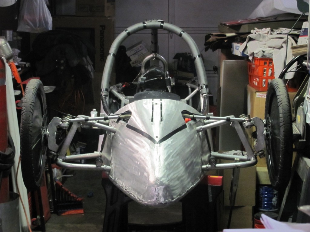

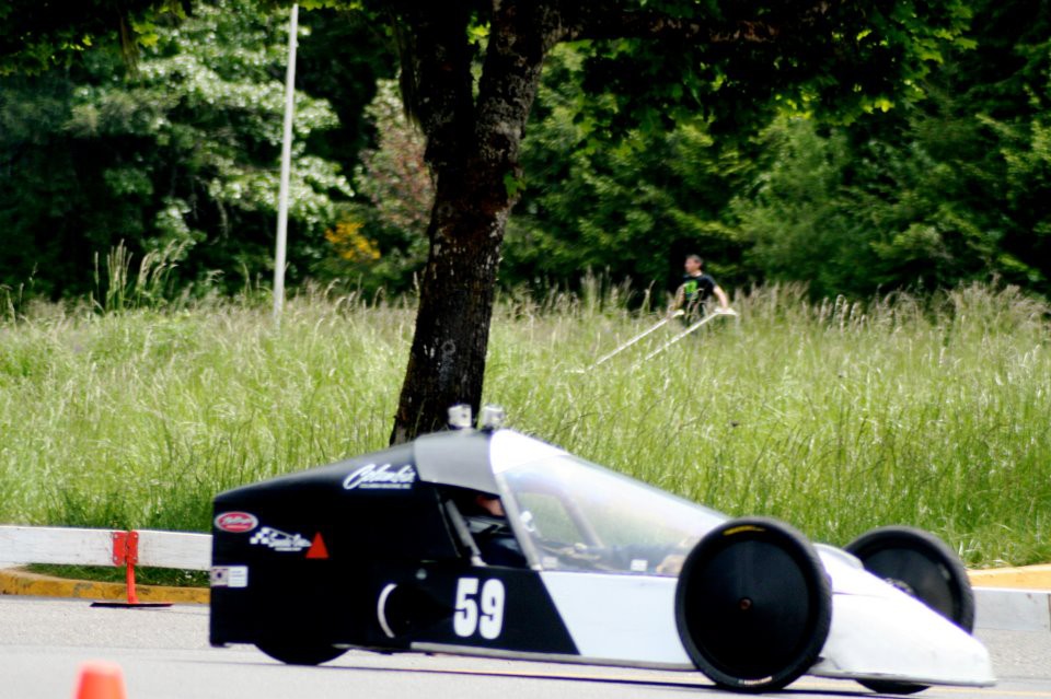

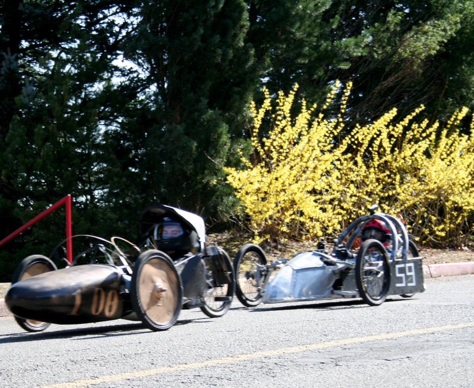

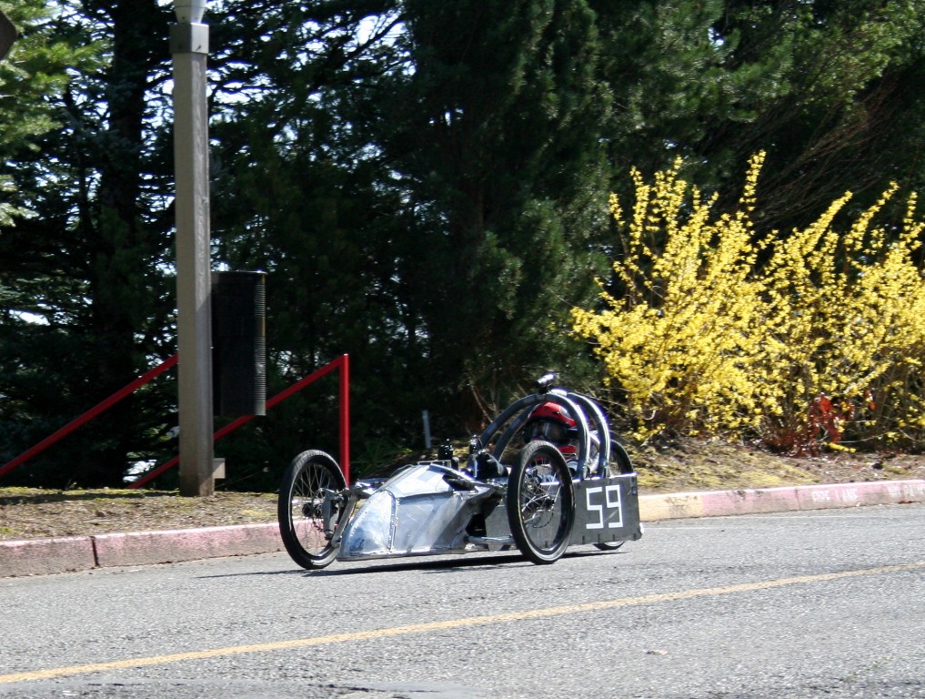

Here is the new #59. Raced at Hood River, it did very well. Some slight changes to my new car compared to #51, biggest difference is the sweeping tapered back end of the car.
Very cool. You and Nathan raced great in Lacy. I hope to get my car done before the end of the year.

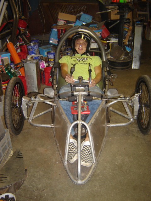

Hey, Zaine I was wondering what size of alluminum you used, how much you needed, and about how much it cost. Thaks, Nicholas Morrell #25

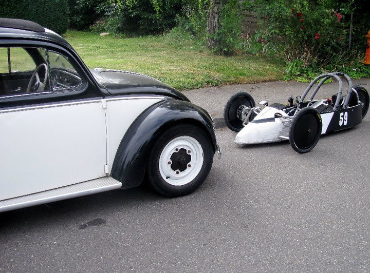

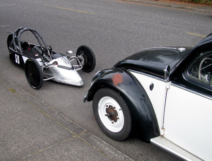

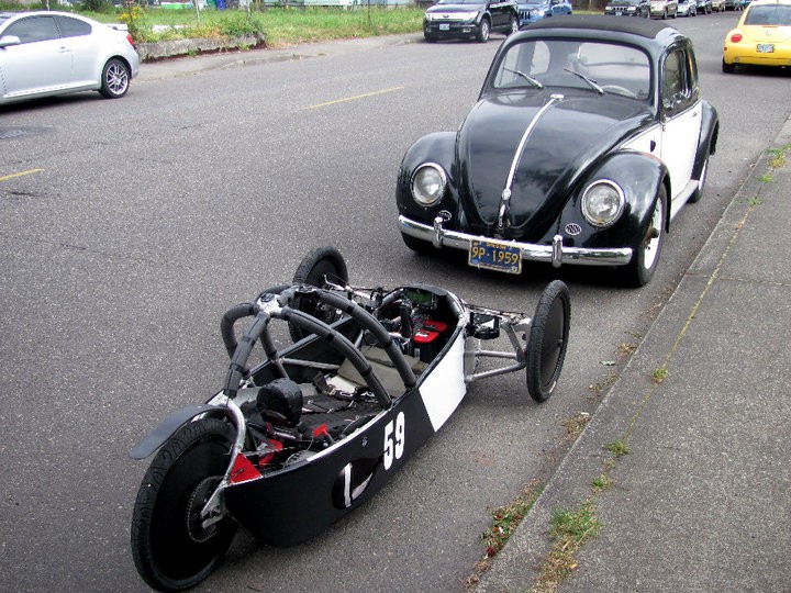

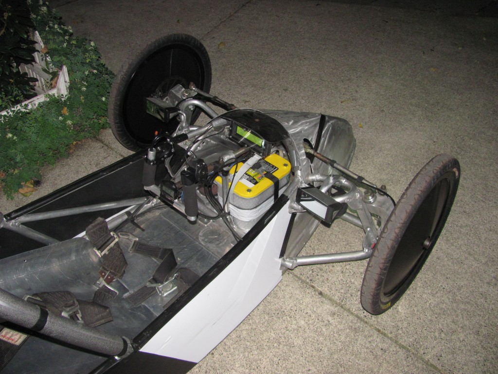

I took these before the da Vinci days race in Corvallis while still in Portland. I bought a 1959 Volkswagen Beetle ragtop sunroof last summer on the fourth of July. This is why my electrathon car is black and white, part of the reason why it is numbered 59 along with the transponder. It didn't occur to me when I realized that 59 keeps following me around, oh well. I like it.

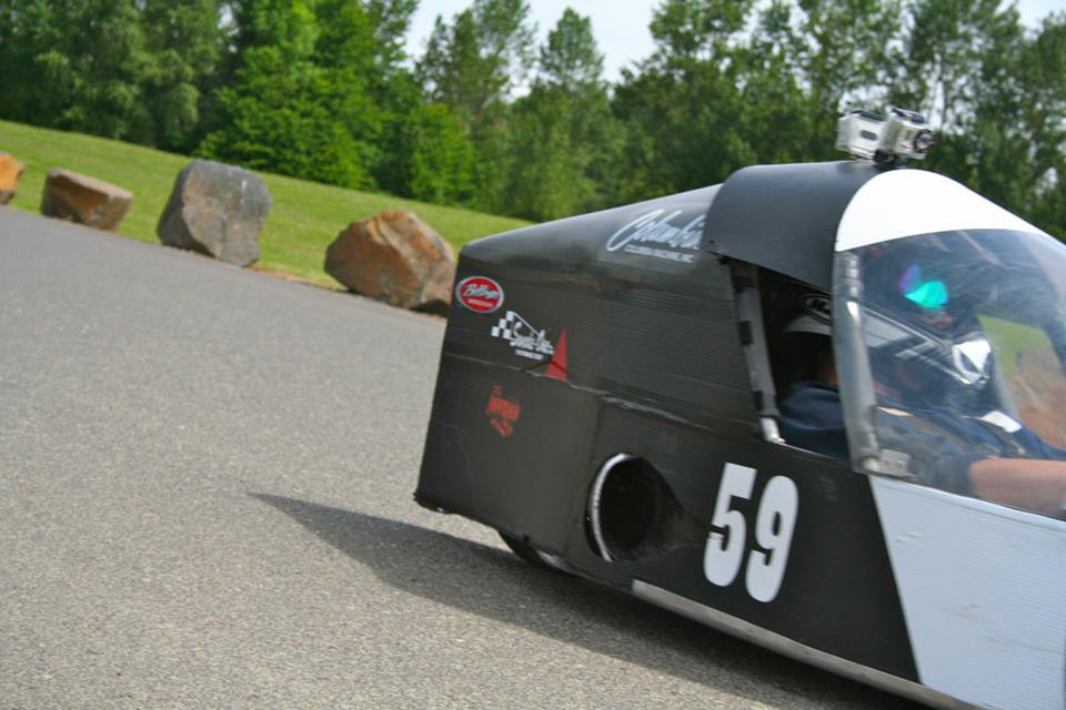

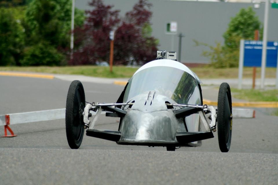

Zaine, tell me about your windscreen. Did you make it yourself? How does it attach? Have you done any testing to see if it makes a difference in top speed and or amp draw? Up close pics?
Thanks
Drew
Sep 17, 2010

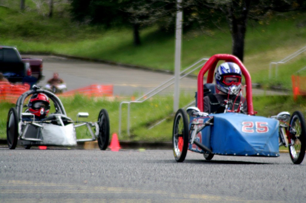

My dad and I made it for the second day at the race at PIR. The windscreen has a hinge on the front of the car made out of aluminum, the rest of the car is also made of aluminum as well. Since the lexan is trying to spring back out, we made aluminum tabs to prevent the bent with two 90 degree angles in it pop riveted, two on each side.
I finished second for the short track at PIR, tied for third on the long track for PIR, second at da Vinci days first time using yellow tops, and I beat everyone including the adult drivers at the Eugene Celebration Kilowatt Klassic also using yellow tops. I think it makes a huge difference if you have a wind screen on a short or long track. I was one of the few cars that was using a windscreen compared to most of the other racers on the course.
Sep 19, 2010

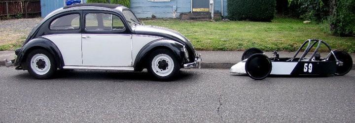

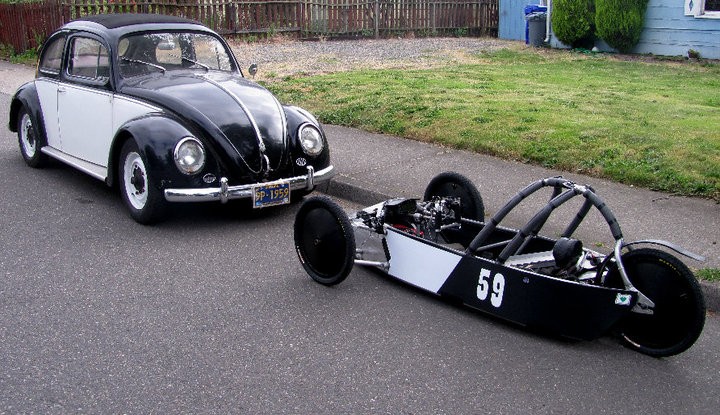

Zaine, Something tells me you need to do white wheel covers with black centers :)
VW and Electrathon look awesome, now all you need is a trailer to tow the race car with the bug!
Sep 19, 2010
I actually really want to do that Kyle. Maybe after college I'll make one, or during college if I do a metal shop class. I just need to find a tow hitch to fit the bug or make one. :p

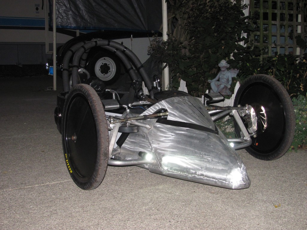

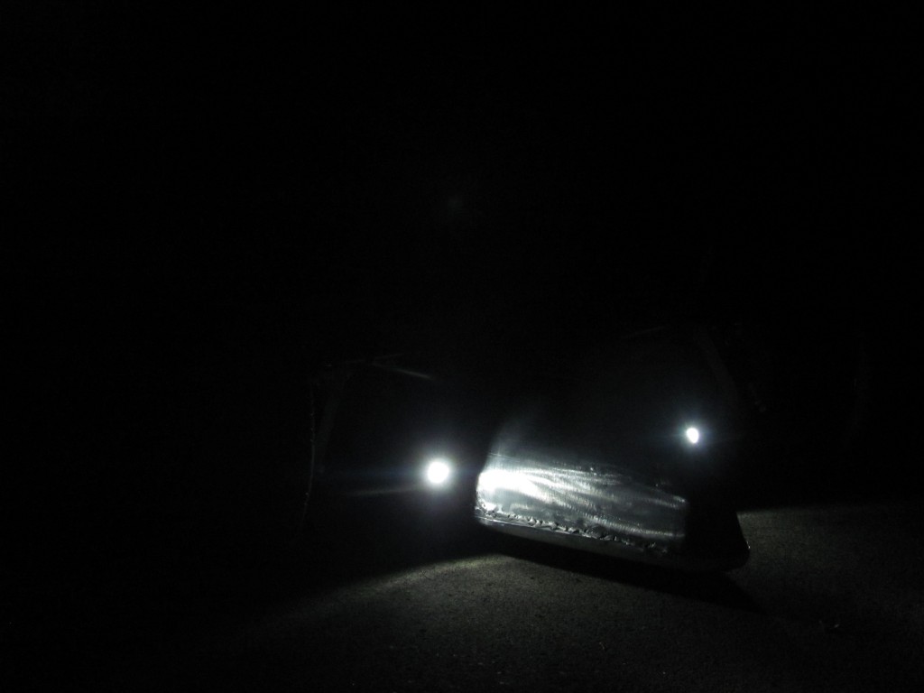

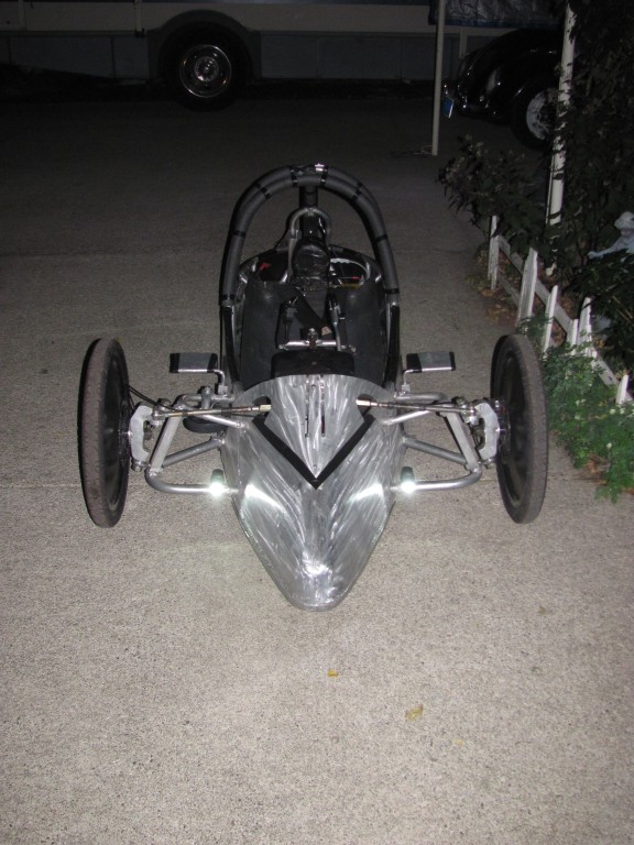

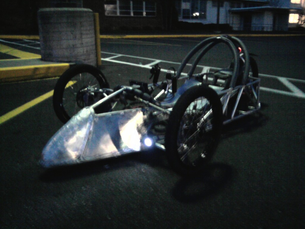

I drilled and tapped mounting holes to hold Harbor Freight LED lights on the front of my car. Consists of a clamp with a rubber grommet on the inside of the ring that holds the LED in place, then tightened down with a button head screw to keep things nice. Its fun to drive in the dark with them on :]
Something tells me an electrathon race under the lights would be VERY fun next season :)
Oct 15, 2010
My dad and I had an idea for a night race at David Douglas high school in the south parking lot. There is enough lighting at night in the parking lot to hold a night race. All of the cars would need two white lights on the front using Harbor Freight LEDs or bicycle lights. Then have at least one or two red lights on the back of the car so you wouldn't run into someone during a race. I think it would be practical to hold a race, just need to get lots of volunteers to help.

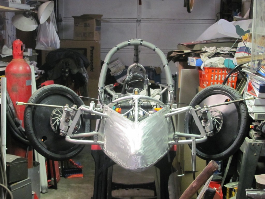

Hoping you could answer this one Aaron. I know your cars (#12,#25,#42) all have hyme joints built into the front steering section. Have you done camber with any of the cars? If so, does it make a difference going around corners? Does it create drag that is significant enough to slow you down? Does it eat up the tires more or less depending on how rough or smooth the track is? I thought I might try some for the fun of it to try different things and experiment for the spring season, since I would be doing the adult class next year. Your one of the few teams that has hyme joints for steering, thought I might ask.
Thanks, Zaine

We have about 15 degrees of king pin inclination (about the same caster). Usually run just a couple degrees of camber, top of the tires in.
In all honesty we have never got it so that during a tight turn things were right. It does seem to work well during the first part of the turn (the first 10 to 15 degrees). As we turn farther we get tire scrub.
Rough tracks are always tire eaters. A smooth track you can get away with more tire pressure, if it is rough we tend to drop the pressure to minimize trashing the tires.
The joints help keep the turning smooth and tight. The also give the ability to adjust the camber in and out a few degrees.

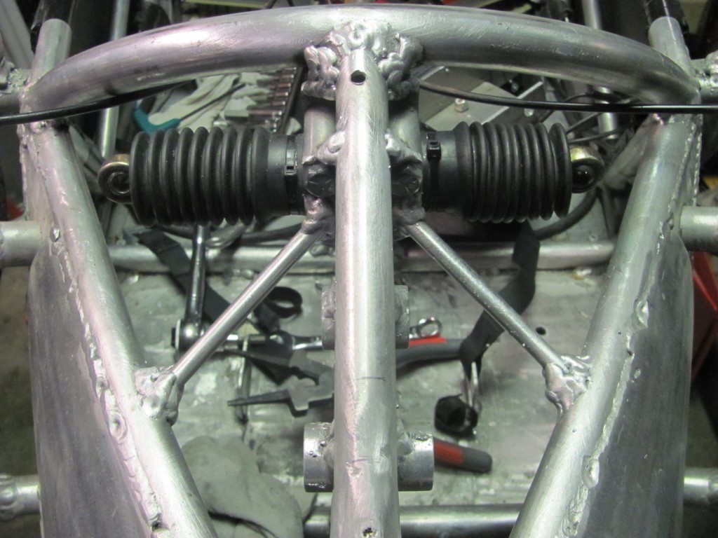

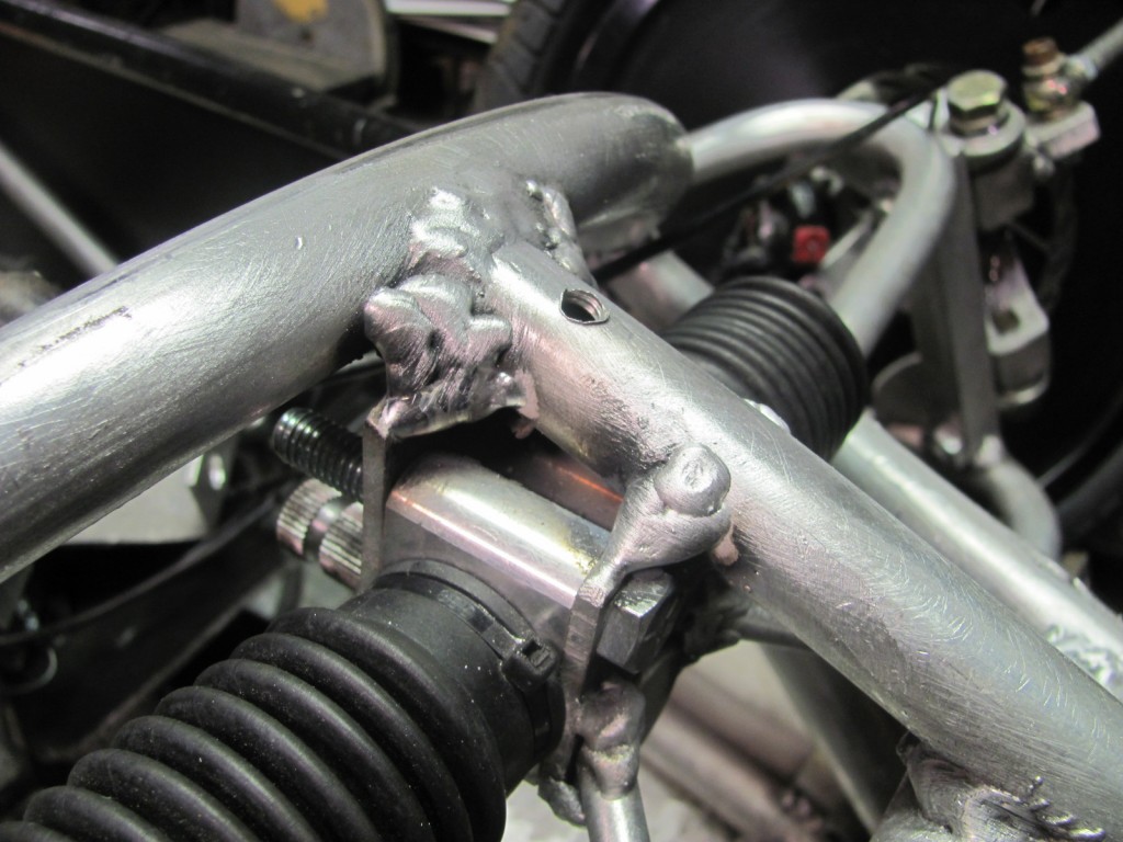

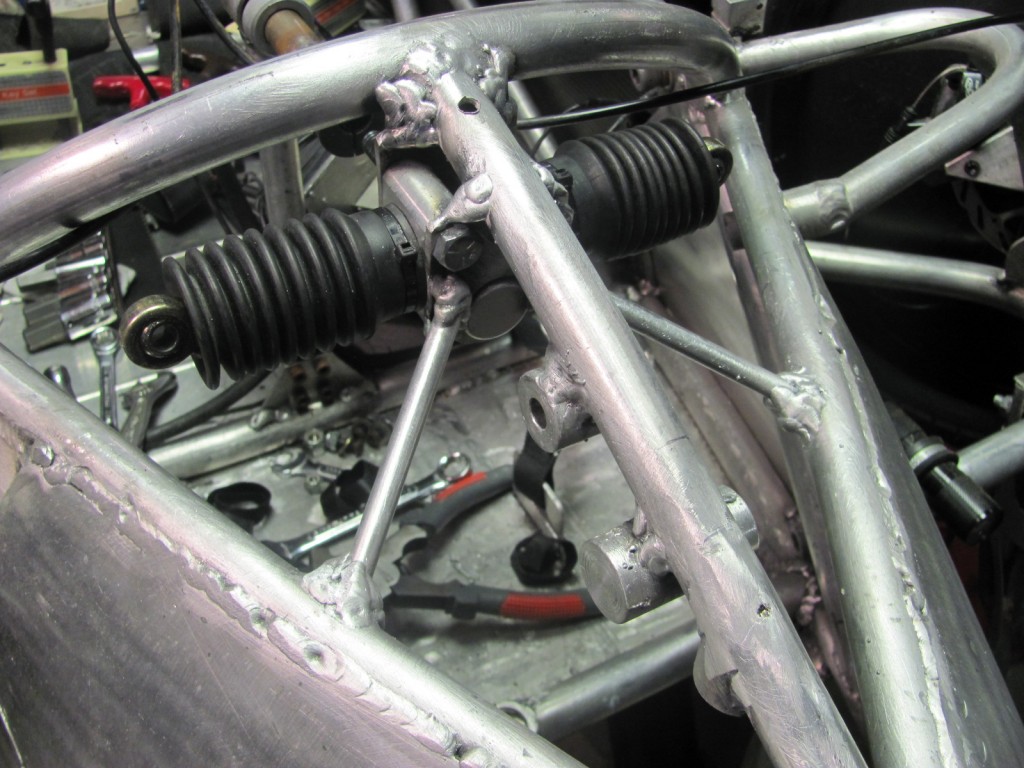

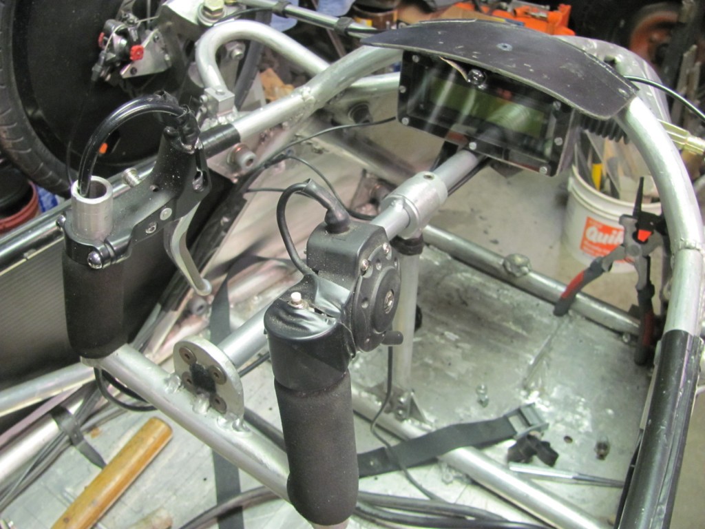

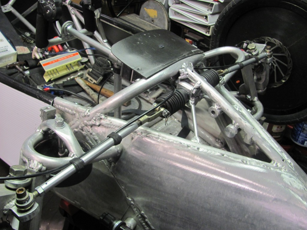

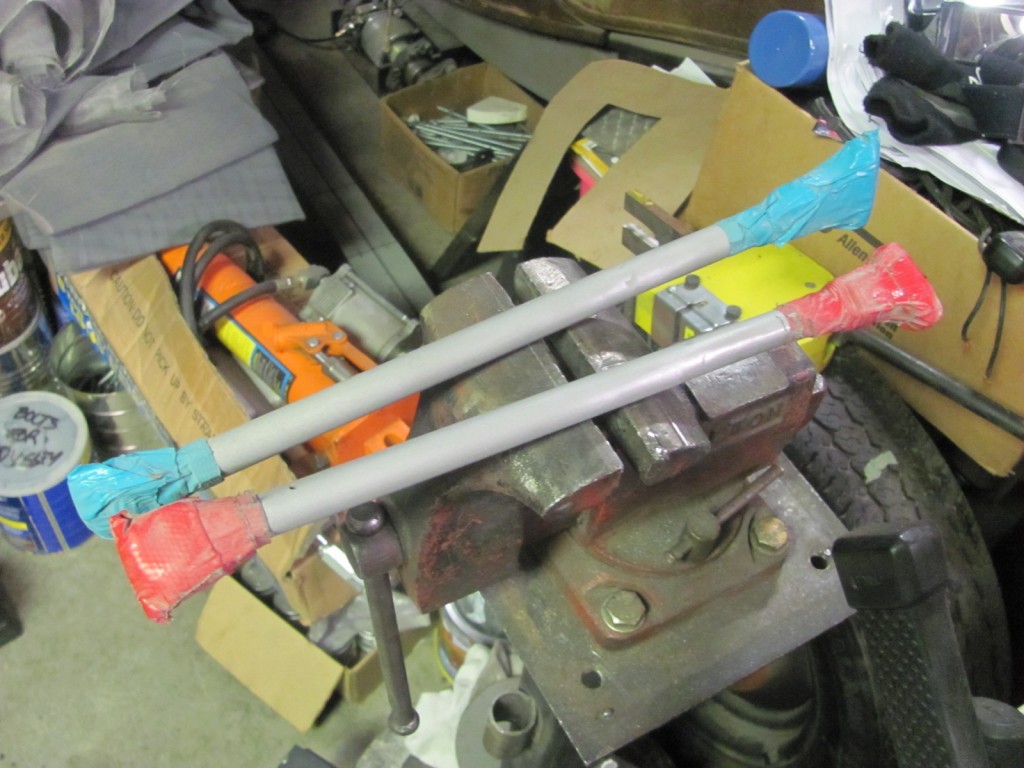

The weekend of Presidents day I decided to do some work on my car to help strengthen the rack and pinion. The rack was all twisted up on the left side of the car before (shown in the first photo.) I only had so much weld to keep the rack in before, and decided to add two 45 degree pieces of aluminum to keep the rack from twisting about when driving (which explained why steering was stiff in the corners to work before this change.)
This would be the last thing I would want to break in a race. If the rack were to brake, I would have no control over the steering. I posted pictures of what I did to the rack, and also decided to paint the tie rods and the steering shaft silver to match the aluminum frame.

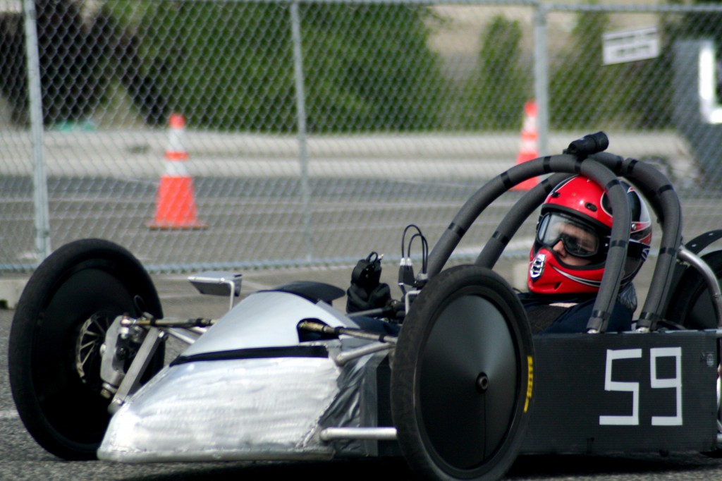

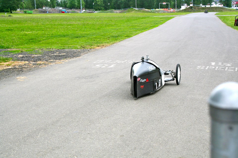

It has been a while since I posted anything in regards to changes to the car. I have white wheel covers now as suggested by Kyle a while back.
But going back five years first off... After the Mapleton race back in 2011, I finally met the Henry family for the first time. I met Barclay, Jayman, Vic, and Sheila at that race. Neither of the two cars had transponders so I helped them get set up so they would work. The race was pretty exciting have never raced against the Henrys before. Both very fast trikes at that race. Barclay suggested I put a tail-cone on my car to hlep with making the car just a little more aerodynamic. Portland International Raceway for Memorial Day weekend was coming up in a few weeks so I did make one that attaches onto the back of the car. I also had optional side windows put in for the long course, again for aero-dynamics. Winglests were put on the upper and lower "A" arms to make them more streamlined.
The next step would be to make a composite copy of the current car to see what that weight difference really does make on the track. Hope to have something for the race at PIR in 2017 in the next several months.

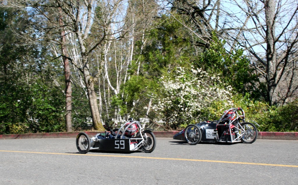

First thoughts on running LiPO batteries at the LCC race last weekend: they are a night and day difference. Still need to figure out a better way to charge them up since my power supply isn't able to supply enough power to the charger to charge both channels at a 1C rate to charge in one hour.
I had to get the car geared as close to what I usually do and didn't want to change the motor sprockets around a ton, so I did the math and came up with a custom 120T monster sprocket that measures out to 14.5 inches in diameter roughly. Even with such a big sprocket making a 6:1 ratio (120/20) the car pulls hard because of the torque. I'm running four, Tattu 6s 14000mAh packs with AS150 connectors in series-parallel to get the voltage up to 12s to take advantage of the lower current draw. These packs when doing the math meet the power requirements of 1Kwh or less of power at 994 nominal watt hours.
I took it easy at the LCC race since I didn't know how the car was going to react with now a 15-16 pound battery pack that just dropped 57 pounds roughly off the car, but to my surprise the car handled really well. I might add in some negative camber to the front wheels to help with cornering, was getting some wheel chatter due to the car having more torque than I am normally used to and the extra weight from running two Optima Yellow top lead-acid batteries.
So far I'm impressed with how the packs performed, other thing too was they were barely warm after the hour run. I only used 848wh, so I still had plenty of power left in them. Voltage on all the cells came down to 3.78v for all four batteries, which for being new I was expecting but for one hour of driving that makes me very happy to see The car was also eerily quiet going around the track, but since I ran a tail cone and windshield I think it muffled the motor noise a lot. Inside the car however, that motor was really spinning up and howling pretty good. Also since the car had so much voltage, I was getting pushed into my seat during and at the end of the race, just to show how much power and torque the car had
