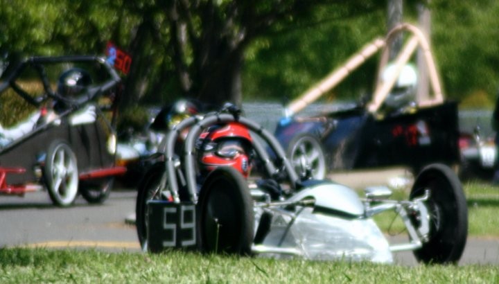

Mark and I just spent the last 3 hours looking at the video of the race. What a hassle! I once again want to emphasize the issue of properly marking the cars with legable car numbers. I would say that at least 2/3 of the cars have absolutly no way of identifying them on the camera. That coupled with the drivers that do not (some will not) hook up the transponder to the 24 volt feed on the car. I actually am having issues after I tell the team that their transponder is not properly hooked up that they are telling me they do not care if it is reading properly and just want to leave it that way. After a year of having misses with this system and finally tracing almsot every error it has to the improper instalation of the transponder, I am astonished that so many racers could care less about hooking up the part that will give them laps!
I am going to say this again (although I am sure not for the last time): Mount the transponder, facing down, 12"-18" above the track. It hooks up to the 24 volt system. It does not hook up to the motor power wire coming out of the controller! This is the reason we have been having issues. It will sort of work, some of the time, if it is hooked up to the output wire. IT WILL NOT WORK EVERY TIME THOUGH! The white wire is positive, the black wire is negative, leave the other wires alone, they are programing wires.

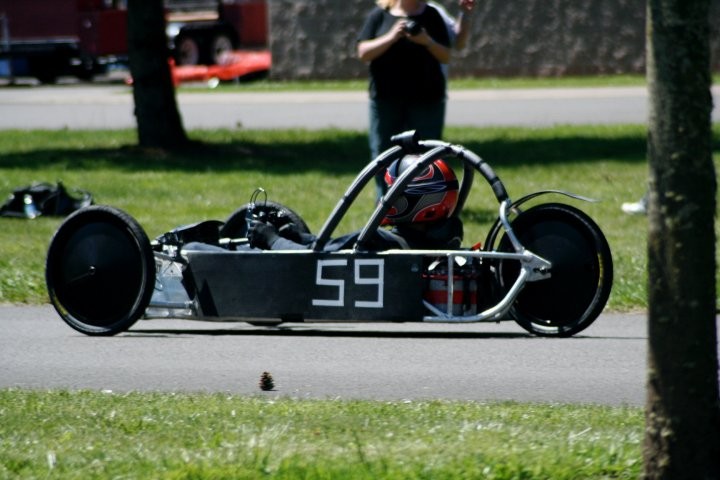

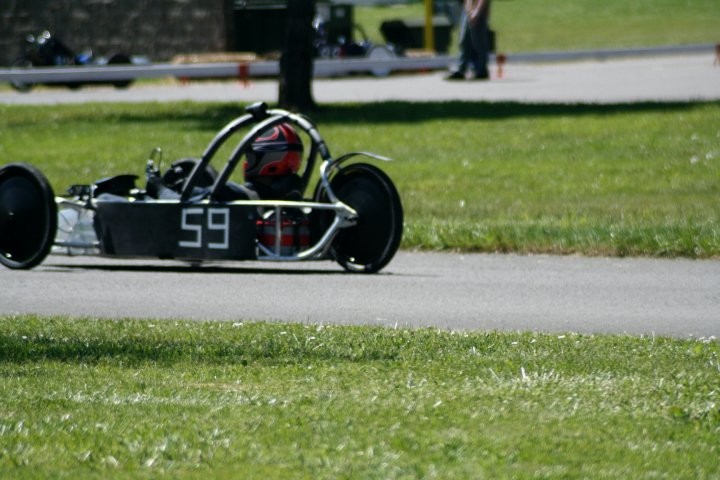

1 59 David Douglas HS Zaine Stapleton 51 00:57.4

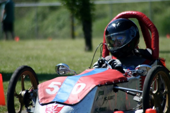

10 50 Centennial HS Mike McMurry 47 00:34.1
