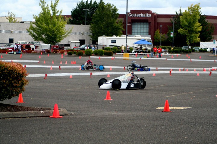

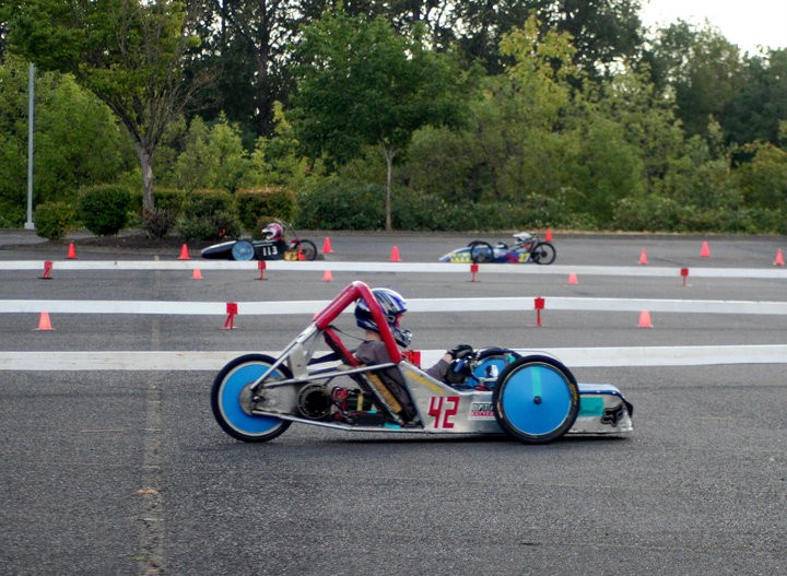

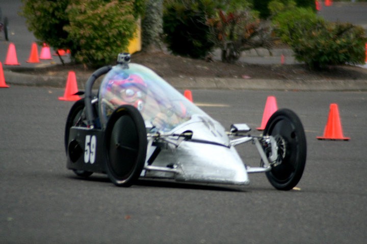

Both my car (#59), the red car from David Douglas high school (#51), and the Centennial high school car (#42) have wheel covers that have this idea. They make the cars look very different in appearance, and I feel they make the car go faster on short or long tracks.

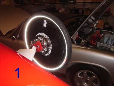

Image #1 - The DESTINY streamliner still uses the plastic sheet style (painted black) on the inside of its front wheels (brake rotor side).

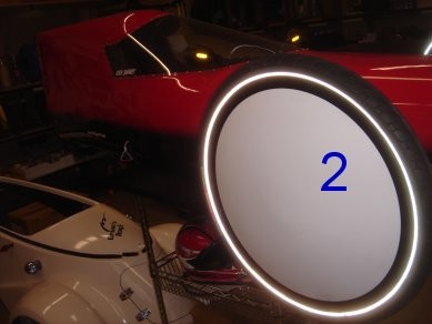

Image #2 - Seamless outside front wheel covers are a little better, but also more work to build. Its 1/16" thick ABS plastic sheet, trimmed "over-sized" by about 1". Then heated in an oven over a dome to shape it. It took several scrap parts to get the temperature and process to work right. We ran them up to 90mph and they've stayed on since installing them in 2007.

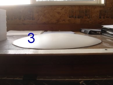

Image #3 - This oversized part is seen on the bench after shaping it in the oven. Then it's trimmed to fit. I created a couple like this to replace the sheet plastic currently used on the inside front wheel covers.

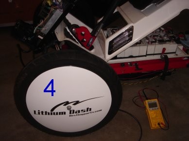

Image #4 - We built a mold to produce gel-coated fiberglass or carbon fiber wheel covers like this. Not intended for Electrathon, this is thicker and stronger because it is designed to be bolted on the axle, not the wheel. It's strong enough to withstand highway speeds without flexing. Another cool effect is that is does not rotate, so the graphic is always upright. It looks very interesting going down the road, as if the wheels aren't turning.
Image #5 - After the learning experiences with various materials and headaches to produce reliable wheel covers, we're now going to run with these. See more at ttp://tiny.cc/taltb. If that link doesn't work for you, Try www.destinyparts.com and enter "wheel covers" in the search box.
