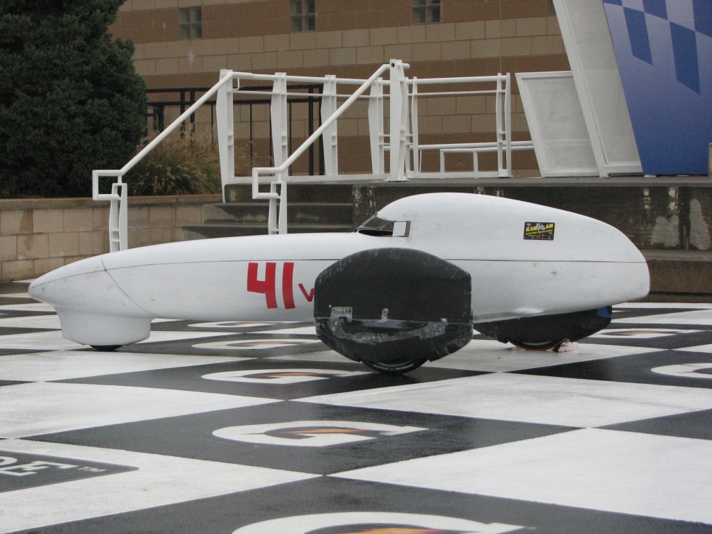

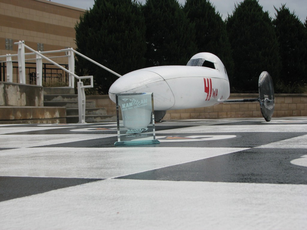

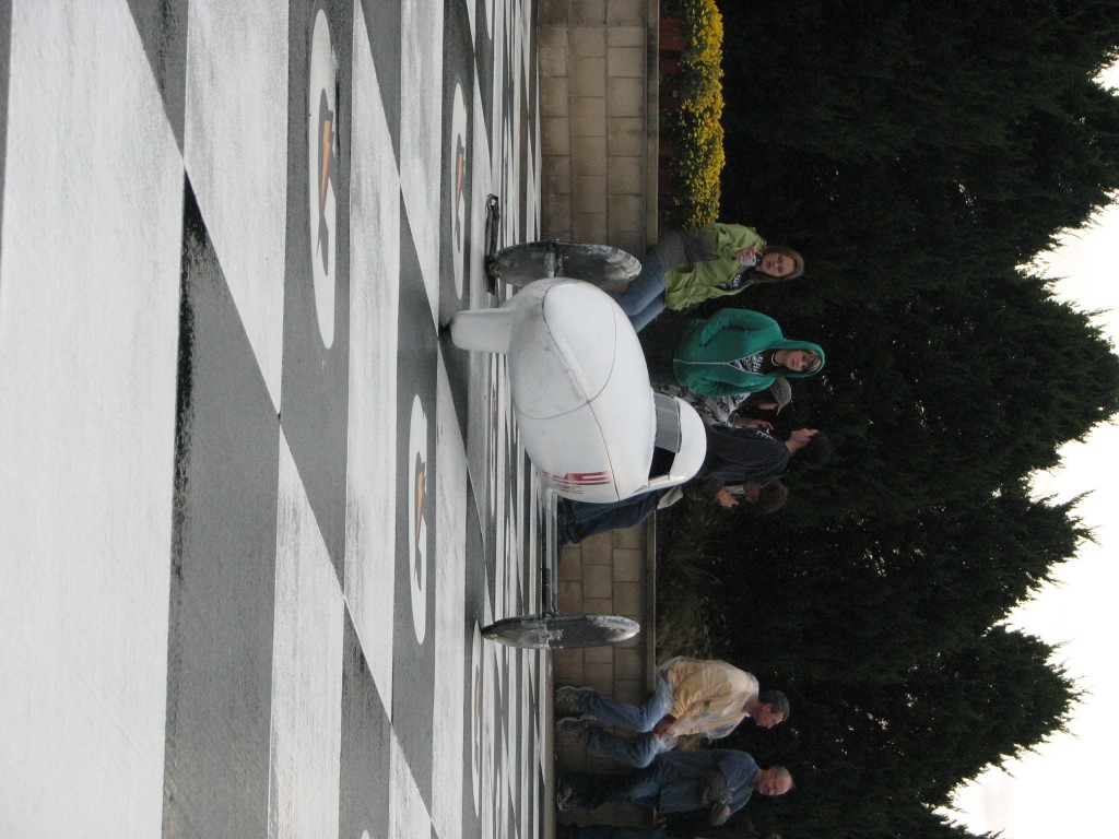

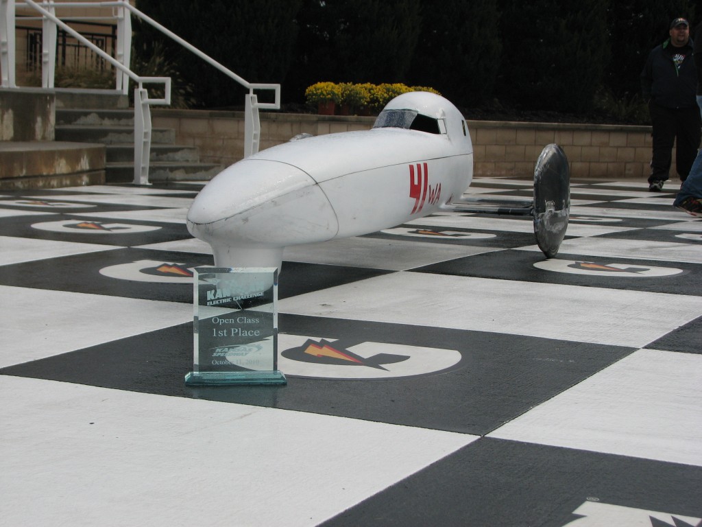

Very nice, is it going to stay white? Or is it going to be painted a different color? Is it running a 24 volt system like the other cars you have?
ShannonCloud said
Nov 7, 2010

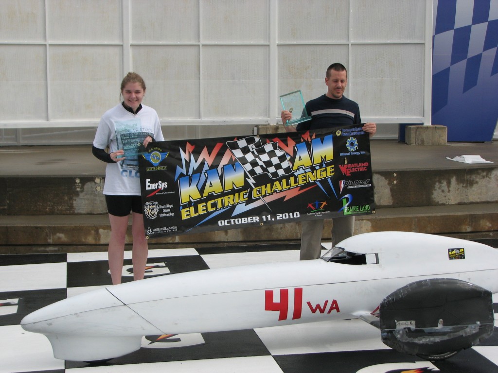

The white is just primer. It will be painted at some point. It is rather similar to the other cars, just a different body mostly.
drewjet said
Nov 14, 2010

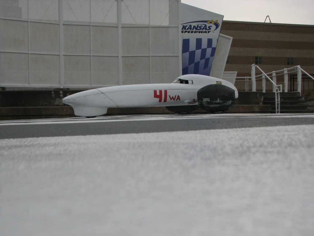

The car sits very high, while most cars sit as low as possible. Obviously it wouldn't be good on short road courses. Does this design have a lower drag coeffeicient? Have you done any actual wind tunnel testing?
Nov 15, 2010
Definatly your best looking car to date.
You have not had a yellow car yet...
ShannonCloud said
Nov 16, 2010
We do not have access to a wind tunnel or anything else of the sort. The car does sit high, Which is out of the ordinary for our designs but it is not necessarily a bad thing. This car proved effective. Not being complete and running in poor weather conditions (rain, a lot of rain) in Kansas we still managed to average over 55 mph for the hour and hit speeds of over 60 mph.
Though this car was originally intended strictly for long courses, I wouldn't be so quick to say it couldn't be used in short courses. Our other cars similar in size and turning radius have managed to win quite a few tight track courses.
It's true, we haven't done yellow. That's a nice bright color! I'll be sure to mention that. ;)

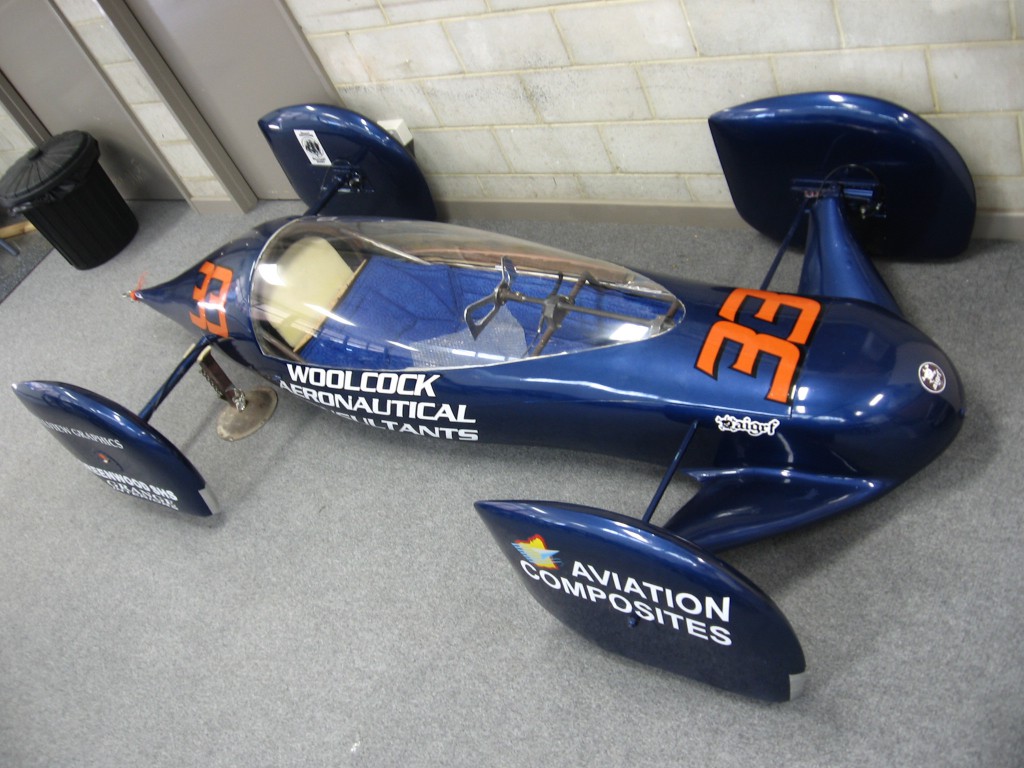

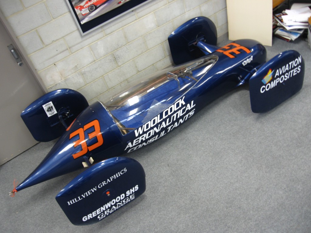

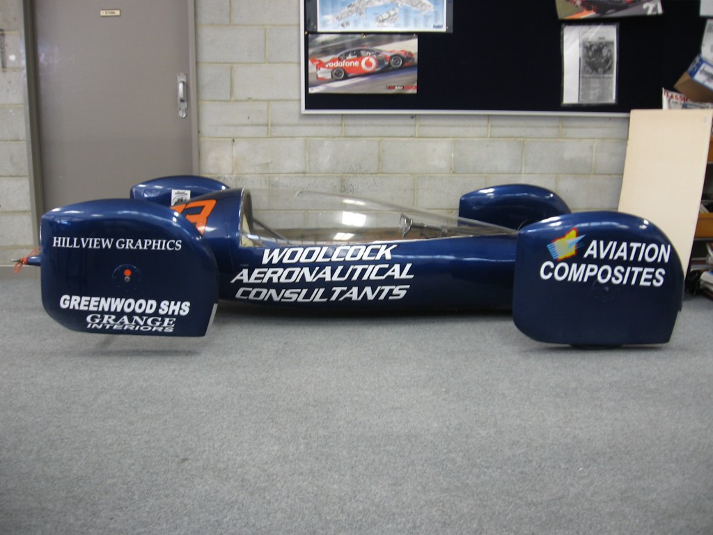

Clay,
Your signature picture looks like a very nice vehicle. Would you mind posting more pictures and some details?

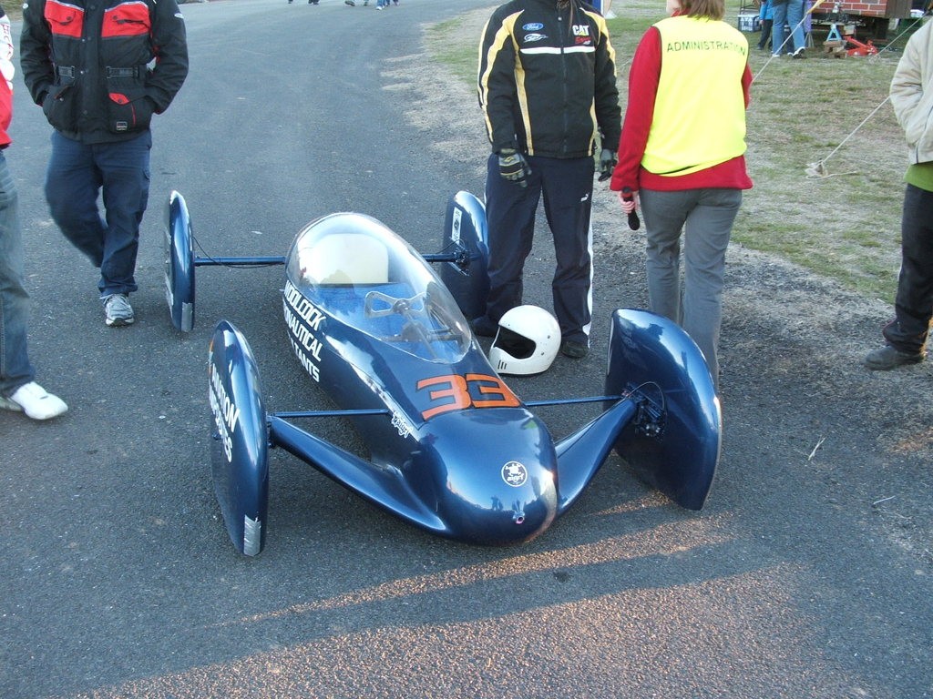

No worries. It's a gravity racer - think soapbox racer. That means no motor/batteries just gravity powering it. I called it the Blowfish, with the blow standing for Bloody Lot Of Work! It's a simple 3/4 inch tube spaceframe with a fibreglass body. Steering is kart style and the wheel covers are all identical built from a mold. Uses 20 x 1 3/8 racing BMX wheels and 4 wheel disc brakes. Has 2 pedals, one for the front brakes and one for the rear brakes.
I built it for a gravity race at Australia's premier race track, Bathurst, back in 2008. I was hoping that the race would be an annual event so my students could build cars to race there as part of an Engineering course but the organisers never held another race.
Nice.
Was the track steep enough to need brakes?
We tried separate pedals for the left and right brake on a three wheel tadpole style electrathon! thinking if we had to waste energy braking, we might as well turn too. Combined with steering, it might have helped a little. We moved to regenerative braking instead.
The Blowfish might make a slick electrathon vehicle. If you can't fit lead acid, you might have room for Li poly pack. How to add a drive system, DIY Hub motors?

No, I don't think it would work for electrathon. It would probably have enough room for a LiPO pack yes, however I'm not too sure about running twin hub motors - plus the track is about 1400mm which is too wide for electrathon. The pedals were ok but we had issues with the balance left to right on the front despite using a balance bar, which caused a spin at approximately 110km/h! We didn't need to use the brakes on the run (although committing to a blind 120 degree corner at 80-90km/h took a few deep breaths) only at the finish, which is where I spun.

Clay, As far as the higher up design, the original point was yes for aero reasons. It seems to work okay, but the car has proven to be a bit picky.
