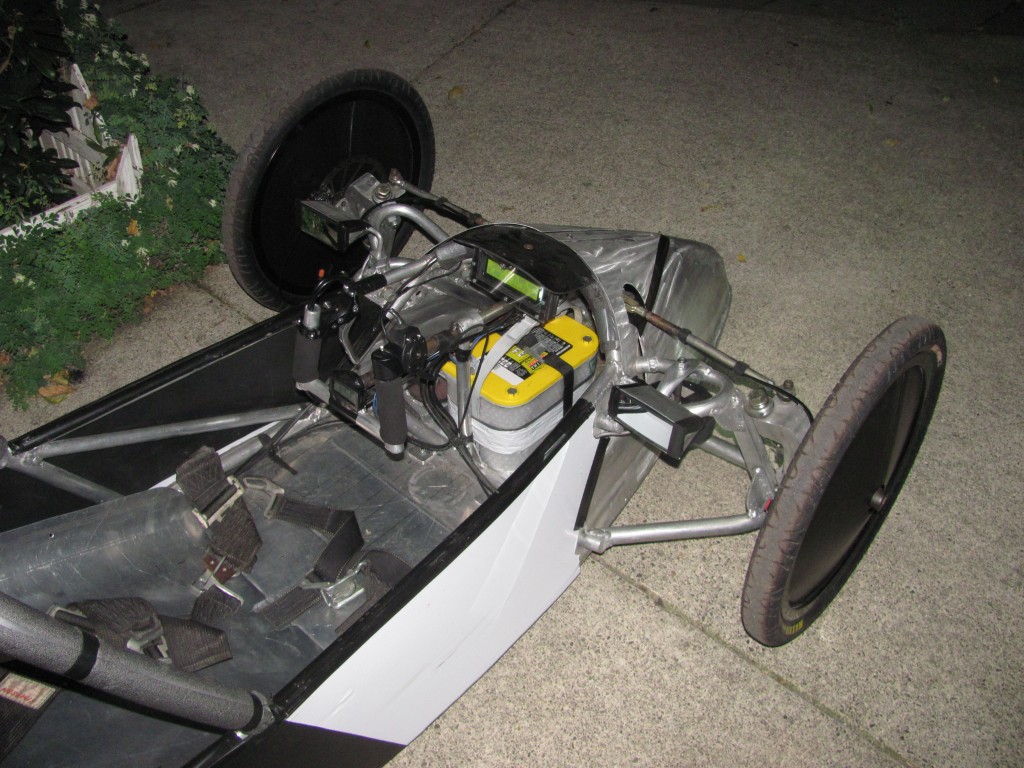

I use a meter in my car (above the battery in the photo.) I feel more comfortable using a meter because I don't have to guess, and it also double as a testing tool. For example, how much can you crank out of your batteries before you go run a race? This way, you can find your max amps (or in my case max watts) you can be pulling for an hour. Mine also has a watt-hour and amp-hour meter so I can check at certain points in the race to see if I'm "on schedule" or not. It also tells me how fast I am going as well which is a nice thing. I feel it's more "car like" in my case, but some people don't run with a speedometer, just meters.
Plus, here in the Northwest (especially the Northwest) we have lots of turns and traffic to deal with when going into corners at high speed, so it's essential to have a meter of some sort (Harbor Frieght multimeter, analog meter(s), digital meters like mine, etc). One thing I did notice over the years starting my junior year and senior year of high school, the top cars here are usually the cars that have some sort of metering system. Cloud has a meter with each of their cars and they have had some really good success all over the place in the U.S. -- Edited by Zaine Stapleton on Wednesday 26th of January 2011 07:14:50 AM
