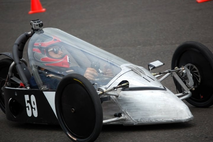

Attached is a pic of one of the better handling cars in the NW.

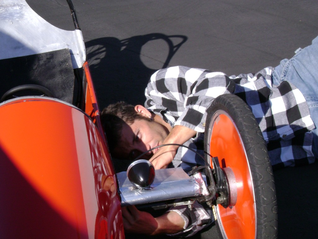

Aaron, who's car is that? Is that one of the DePew cars? Was this taken at PIR?
Yes, that is a pic of Jake DePew working on his car. I do not remember where I took it.
