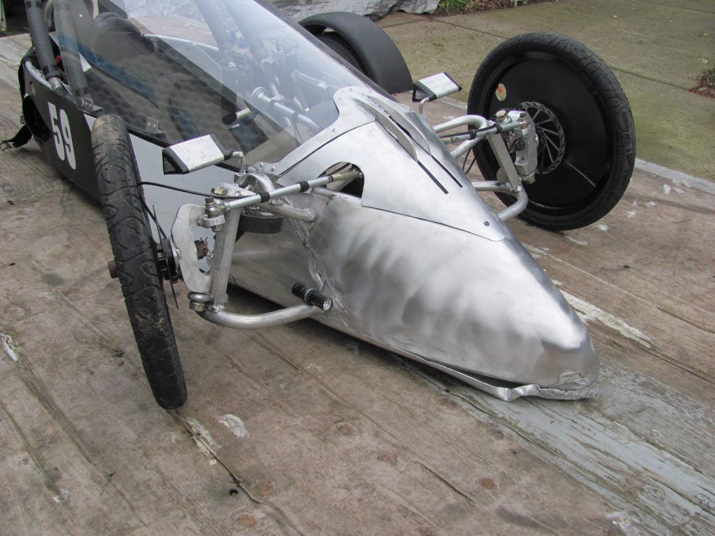

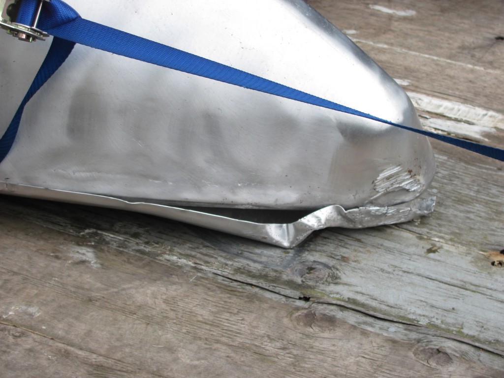

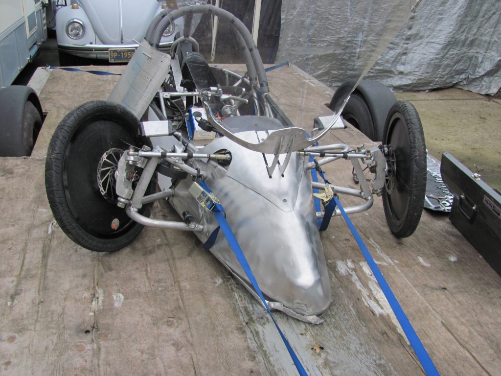

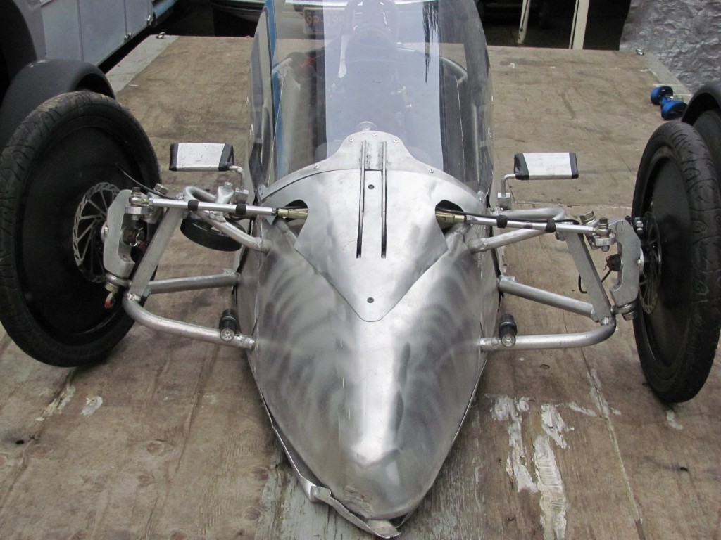

I believe there needs to be a rule about having enough nose protection on the front of the car. I found this to be helpful in my case when I built my car. Last year we designed my car to have 1/8" aluminum plating on the nose of the car. The same goes for the #51 and #55 cars at David Douglas. Not only did it help with aerodynamics, but if I ever came in contact with a curb at high speed. Two weeks ago, I was trying out some different batteries and doing an hour test on them to see what I could do with them. This is what happened.
About 40 minutes into the practice race, I came to a part of the course where I was at where there is a slight down hill that drops about 6-8 feet. After this drop at the bottom, there is a left turn that immediately goes back up 6-8 feet. I came in doing about 28-30 mph and turned too late to apex it. The wheels started to slide as understeer came in since it was wet out, I then responded with the brake (which didn't help the situation), proceeded towards the curb at about a 45 degree angle and hit the right side of the nose with it. I was truly shook up after hitting the curb, but taught me a lesson about wet tracks which will be helpful at later races when it's raining. The right front a-arm folded up when I hit the curb, the wheel did not break but did leave a dent in the rim and was warped beyond use, and the nose got smacked really hard.
Aside from a couple scrapes and bruises on my knees and the damage to the car, the nose did it's job in protecting my feet. I was able to get out and still walk faster than the crash with the Hood River car last year that halted the race for 25 minutes. If I had a canvas front end with a couple pieces of aluminum tubing like four cars here in the northwest or polyethylene plastic on the nose with some square or round steel tubing underneath it, I would have broken my feet. I have noticed a lot of the cars here in the northwest don't have adequate enough nose protection if they ran into a curb doing 15 mph or faster. There could be a lawsuit at schools if their students get hurt due to how the teacher(s) are having them build their cars. I know most of the cars in the Northwest I would never get into even if they asked me to drive one of their cars due to the lack of nose protection.
This needs to be a rule for 2012. In the Northwest region, 2/3s of the cars here don't have enough nose protection. If looking at the whole USA's electrathon racing, 99% don't have enough protection to survive a crash without breaking almost everyone's feet whose driving the car. Yes, it would add some weight, but better safe than sorry is how I look at it. This is coming from a safety point of view for everyone that could get seriously hurt by over looking one thing on the car when building it. And it does state in the rules that frames have to be built a certain way to not allow a persons body parts to pass through the frame while driving or when a crash happens. Either get a fiberglass nose that's thick enough or add plating to your car to make it safe enough to withstand a direct hit to the nose while protecting the drivers feet at the same time.
