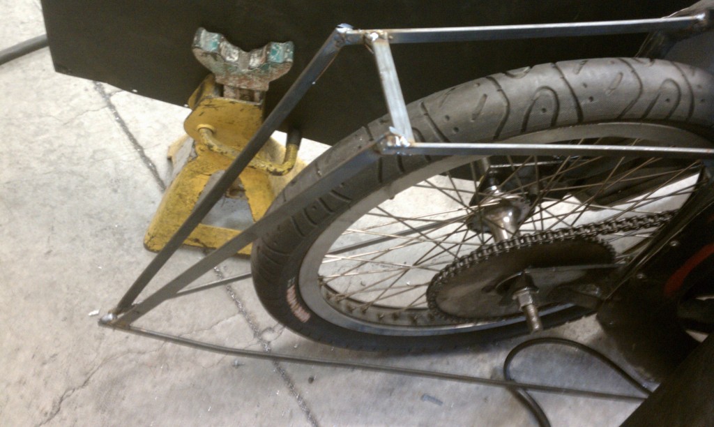

On mine I made a metal cage that went around the back wheel, and welded it to the back of the car. I then pop riveted plastic to the cage, and the back of the car. I then put some tape on the edges.
