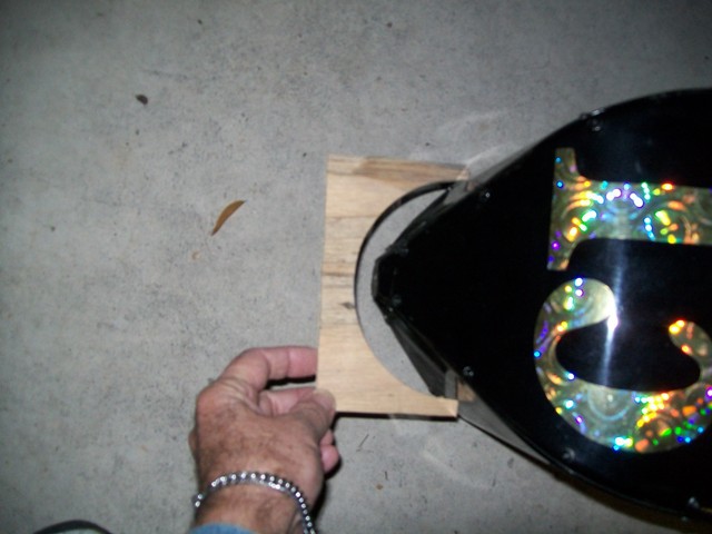

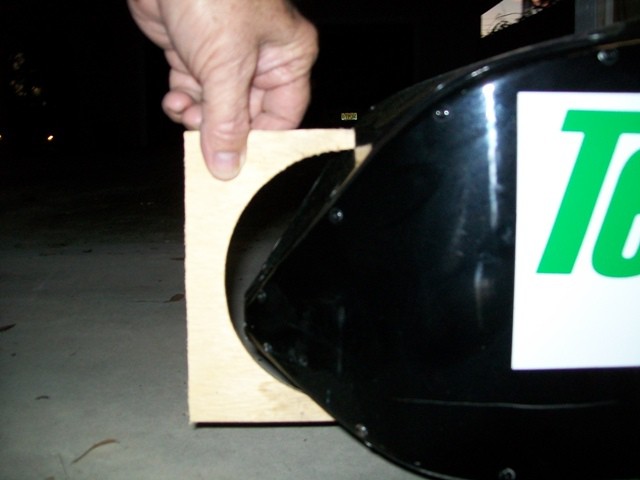

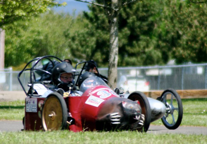

8.PROPOSED CHANGE (1/18/13):Add to rule 5 on page 7: The nose area must have a minimum radius of a 3 sphere
-There have been safety concerns with nose cones having the potential for piercing of other vehicles, spectators, or other persons especially during crash scenarios.

What is the definition of "3 sphere" ??? I really have no idea, but some rule eliminating front-end points is long over due. OK got it, but it was confusing at first.

RULE #8 ADD TO THE END OF minimum radius of a 3 sphere ****(6 inch diameter)**** TO AVOID ANY CONFUSION

RIGHT, IT SHOULD READ 3" RADIUS AND 6" DIAMETER

8) Again the rule say can not have any sharp parts that can penetrate another car many did not see that a sharp point on the nose violated this. I think this happens more in areas with high speed tracks like 2 mile Nascar ovals.

rule 8, if pass ,will rule out more then 95% of all the cars we have now. and do noting for safety. David Cloud

8.PROPOSED CHANGE (1/18/13):Â Add to rule 5 on page 7: The nose area must have a minimum radius of a 3 sphere
I would like more clarification on this please, as to me it is quite vague. There is no mention of materials, structure, or integrity. I could easily see someone just taping a party balloon to the front of the car that would meet the description. My point is that it would be simple to put a flimsy plastic/fiberglass cover or body panel over more substantial body structure that would not otherwise be approved. If the concern is that the front of the car has a shape that becomes a danger to other drivers, should we consider something more like a bumper or crush-zone? The shape alone does not define the level of safety.
My car for instance, has a somewhat pointed shape to the nose, but that is very flimsy fiberglass which does yield if there was an impact strong enough, which I have seen firsthand. It has been repaired many times. Its main purpose is aerodynamics, not structure. But behind that is a very strong blunt structure of about one square foot area that would not yield. Is it safe or not? I think it is quite safe, although it would not meet this proposed new rule as it is currently worded.
Also, in my experience, the largest direct danger to me has been axles sticking out. Those will punch a nice small hole in whatever it is they contact, whether it is another car or another driver. This is something else I have seen firsthand. We do have a rule for that already, but maybe that could be improved as well, to require that axles must have a 2-3" diameter hub cap to spread out the impact. That is part of why my car has all of its wheels completely surrounded with some kind of structure. It is defensive for one, but also keeps my car from damaging others when they do come into contact.
David O.
Dave,
I can only think of a few cars that would not pass this standard. Your cars should pass easily. The radius may fail in one direction but would pass in the other. It would excede the minimum raduis test by rating it the other direction.

How would this rule work if the definition was to read something like the minimum front nose cone must have a combined distance of 12" horizontal and vertical when measured 3" from the tip. So if a car was 4" on the horizontal then it must be 8" on the vertical direction. Again this is when it is measured 3" back from the very tip. It would not take much to make a caliper of sorts out of something like a ruler that had a 3" long 90 degree arm coming off of the end of it and a 3" long slide that moves along the ruler to measure the distance accurately within a 1/16 of an inch. This would measure the width 3" back in the horizontal and in the vertical and then add the two measurements together. I know Dave's new car and it is not anything that would puncture another car and endanger the driver of another vehicle. It is fairly tall but narrower than I remembered it being. Dave see if your car would qualify in this system. I am not married or really pushing any of these rules but think that some clarification is needed for safety. After looking at some cars we occasionally see in the NW and have seen in pictures at other races, I think we need to limit how pointed a nose cone is. Things like the cars that 'bd64' posted which are just plain scary but the rules don't forbid them except in spirit. Lets be creative in thinking of how to not allow a dangerous car but let in all of the safe cars without making them redesign their cars. This is where the creative minds of those in this group can be very helpful and help shape the future of EA and improve safety but still allow people to be inventive. Mike
cloudvolt said
Feb 1, 2013
Mike, So we can have a 6"d flat with a 2.9 spike or (bd64)sticking out of a beach 2". But not a 16" hookworm leading the way. David
cloudvolt said
Feb 1, 2013
beach ball
Feb 1, 2013
Dave, I don't know how to word this!!!! That is what this is for. From others in the forum under "pointed nose" there are those that feel we need to add a rule about 'how sharp a nose can be." We have the one army national guard car that races at Lacey some times that is scary to be on the track with. GIVE US SOME IDEA HOW TO WRITE THIS RULE so all are safe. I don't want to be the only one trying to fix the problem. My car, the fiberglass Wolverine nose cone i build does not fit the 6" diameter sphere rule either so if it passes I need to remake my car as well. I am just trying to do want some members said they wanted!!!! Mike

Not stupid but here's my suggestion:
Rounded noses: The radius of the nose shall be no less than 3" in any direction. (This would include the distance from the tip)
Flat noses: The height and width of the nose shall be no less than 5.25 " (Approx area of the 3" radius)
Pointed Noses: The sharpest angle in any direction shall be no less than 45 (or 60 or whatever) degrees. (Note The Robinson's/meangreen's nose)
Trying to avoid a one size fits all solution.

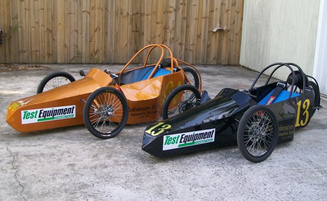

It looks like the shape of a car's nose is the biggest stumbling block we're having...
Mike Frederick mentioned (posted above) my cars as a possible example, so here they are. Notice that they do not come to a sharp point, but each car has a 1.25" diameter flat fender washer integrated into the nose. That was deliberate to reduce the possibility of puncturing the bodywork of another car in a collision. Mike Hodgertt suggested a plywood template with a 6" diameter half-circle cut out to use as a gauge, so I made one. I checked the noses on my cars both horizontally and vertically and happily discovered that they would pass this type of inspection, but I would guess that some of the cars here in Florida might not. Most would pass one way, but possibly not the other. For example, one of our long-time competitor's cars would easily pass the horizontal test because it is about 20 inches wide and straight across, but vertically it has the body sloped downward and has about a 2" diameter rolled shape at the front bottom edge. Even the Blue Sky Aerocoupes, with the lip at the bottom, may be questionable depending on how the gauge is used. The "go; no-go gauge" could be a good idea with a little refinement and instruction on how it should be used. Also, whatever we decide on design, maybe we should include a delay in enforcement. For example, state that cars must comply by January 2014. That way we aren't immediately scrapping half the cars in the country right in the middle of the current season.
I cast half of my team's votes to pass and half against the nose cone rule. I did this since we have not figured out how to word it and make it work for all thus I sort of abstained in the voting of this rule. I sort of like my idea from above with maybe a different line than the "rounded in shape" but it is still not all inclusive:
""The structural part (rigid fiberglass, or metal bracing, or ??) of the nose cone's very tip must BE REASONABLY BLUNT AND NOT HAVE A SPIKED NARROW POINTED shape and the front area must at a minimum have a combined distance of 12" horizontal and vertical when measured 3" straight back from the tip. (Example: If a car was 4" on the horizontal then it must be 8" on the vertical direction.) Again this is when it is measured 3" straight back from the very frontal tip of the car.""
With this rule Blue Sky cars with the flat bottom but fairly wide and blunt nose above that would pass, and the 20" wide and 2" tall Florida car would pass, Cloud's cars would pass as they are 4.2" X 8+", my car would pass as it is 5" wide and 8" tall.
Can anyone come up with a better idea or wording? Again we all agree that we need a rule like this but it is hard to put into black and white what is safe and what is not.
Feb 4, 2013
Mike,
So are peopel voting now? You said you split your votes.
Feb 4, 2013
Honestly after reading the last couple of posts for this rule change this is getting way too complex and fustrating for everyone who chimes in...
How about just a rule that says no pointed nose cones/frontal areas on the cars period. No fusing around with a stupid guage that would stir up arguments and set the start time even further back before a race. Just keep it simple, which is one of the main goals with Electrathon racing.
Examples: rounded points like my car, wide areas like Mike's car or the Centennial cars are okay; just NO POINTED NOSE CONES AT ALL. Best example I can come up with is (Mike or anyone that was in the 2010 race season can agree) car #107 driven by Alec Robertson/Preston Henne. They had a definate pointed nose on their car that did come to a long point. Another exampe would be the Clouds newest car, not the purple pink car, but the white car. This car does have a point on the nose of the car, but they have a tire up front and the point is not that long compared to #107.

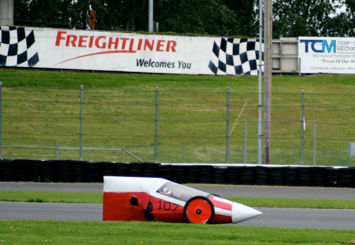

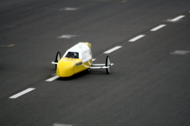

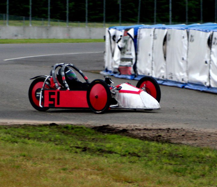

Look at the following examples I've got on here. These are photos from the 2010/2011 season in the Northwest.
My car #59 has a rounded point that is down low. I would say this would pass according to the no pointed cones/frontal area.
Same goes for #51, rounded and down low.

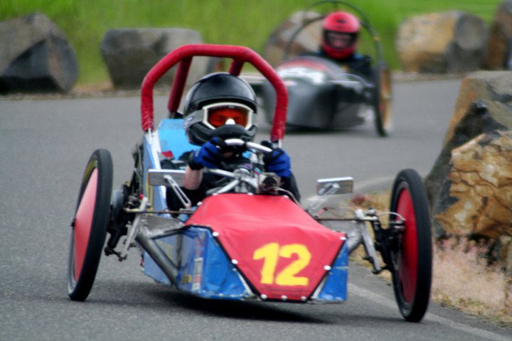

Centennial #12 would pass. Has a wide area, and the 'point' in this case is down low.
Hood River #32 would pass. Wide area up front.
The Henry's #2 (the yellow/white car with the smiley face) would pass. Point is ramped down, and is sloping downward too. Yes, it does sort of have a point, but it's down low so this wouldn't be a issue.
Mike's car #38 would pass. It's rounded and there is such a wide area on the front it can't pierce another car.

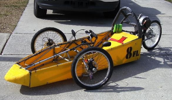

Florida car #8 would not pass. Point is up and not low to the ground. Plus the point is not rounded (correct me if I'm wrong, but I'm using this as an example. No hard feelings against you or your car.)
Kirk's #555 would pass. Yes, it is sort of a point. But it's rounded and I've seen his car when it's not moving and the nose does sit low to the ground. Plus it's vertical as well on the front.
#107 would not pass. Has a definate point on the front. Point is also up high so this could pose as a threat incase of a t-bone situation.

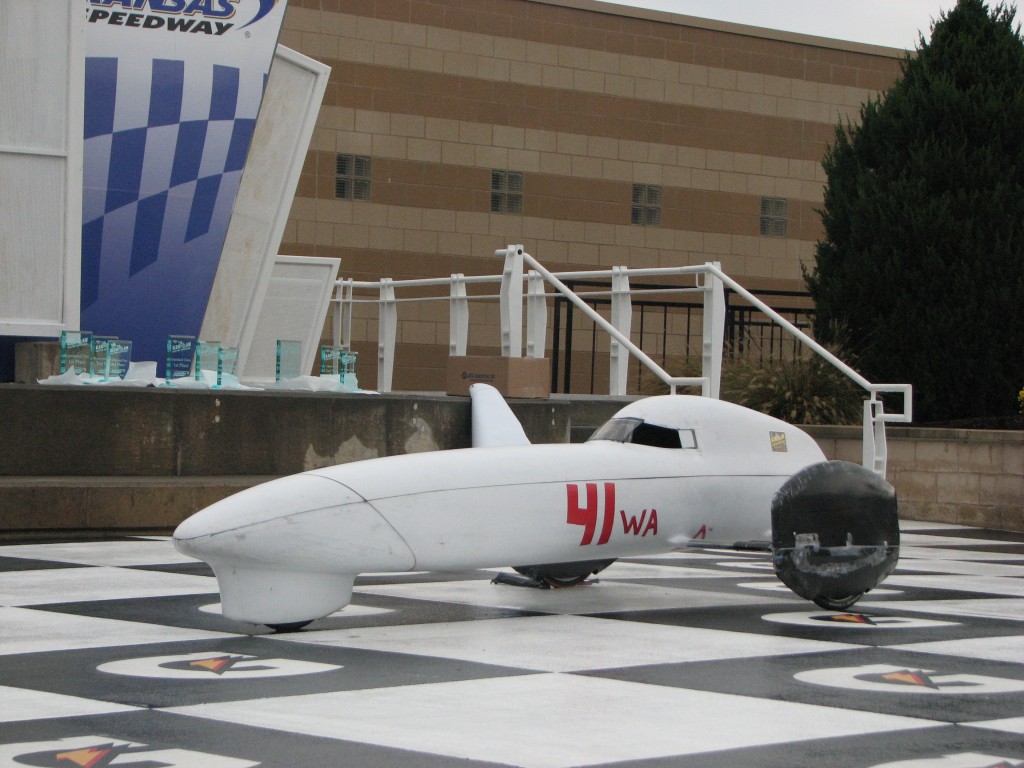

Clouds #41 would pass. Yes, it does have a point up high, but there is a vertical section on the actual nose of the car since it is front wheel drive. And it's a short rounded point.
Pictures like these could be used for good/bad examples in the updated rule book if that is still happening or not with an explanation of what you (the builder) is trying to aim for. This is my suggestion to keep things more simple for everyone, and to keep people from getting more agitated as well.

NOSE CONE PROPOSED CHANGE*********
Dave and Aaron. Yes the 3" radius 6" diameter sphere nose cone was to be in all directions. I measured the Destiny body in our shop and at 3" back from the tip it is 7" across so it is larger than a 6" DIAMETER sphere in all directions. I will have to measure my Wolverine face nose cone and see if it qualifies or if I will need to modify it if this rule passes. Again this was a rule on the forum for the last year with little input!!!!
As far as a balloon attached to the nose....I agree that the letter of this rule would allow that but that is obviously not what was meant. So the wording needs to be improved. We want a structural part of the car that has this size or larger. As far as a sharper nose being better for aerodynamics any wind tunnel test will show that you want a slightly rounded nose cone not a pointed one unless you are near supersonic speeds. A pointed nose caused a wider bow wave and more drag at the speeds we are traveling than a slightly rounded one. Fiberglass is not necessarily flimsy as stated above. I have seen a well built sturdy nose hit a post head on at ~30 and only slightly crack when the metal hoop inside it was 3" further inside and the fiberglass nose cone by itself is what stopped the car. So a very pointed fiberglass nose could take our ribs, kidneys, etc. in a T-bone crash. To test this rule I would propose that we find some round bowls or ??? that are about 3" deep and 6" across. If we put them over the nose cone, does the bowl touch the car at the bowl's rim (top) or is the nose cone too pointed and it touches the bottom of the bowl and keep the rim from touching the sides. If this part does not make sense let me know and I will try to do a better job of explained this testing method.
Mike Hodgert--president by default of Electrathon America.
If the radius is in BOTH/ALL directions I have to agree with Dave, virtually all cars in the US will have to be altered. None of our cars will pass and none of the new cars we have built this year will pass. A flat bottomed car with a very large (12") radius upwards and 18" raduis nose side to side will fail this standard.
A bowl could not be used to test because the one side being greater than the other would stop it. You would have to use a flat guage and test it in multiple directions. I feel that a 12" tall nose with a 3" diamiter side to side (think Cloud car) is less likely to punch into a car than a car with a 6" ball nose on it.
By your description I am oposed to this change.
Aaron -lap counter and forum administrator by default
NO , the bowl will not work. if the top view is like (>).David
In my opinion you do not need both rule 8 and rule 9, only rule 9. If a car has adequate sidewall protection, then car's piercing each other should not be an issue. I would think it would be easier to put a little more structure in the sidewall than having to re do the entire front end of the car.
Also since we're talking safety, maybe there should be an inspection for weld quality/ fabrication techniques specifically for the roll cage. I've seen quite a few roll bars that look like they would fold in if they were actually in a roll over. Or maybe better enforcing that the bar must be above one's head ( have seen a couple cars with heads above the bar). I admit the weld inspection may be going a bit far for mostly high school students, but I do welding/fab for a job so I am more critical of those things.
This is the type of construction Rule *8 is trying to address. Fortunately, these vehicles are no longer in existance and I hpoe no others like them will ever be made.
This is Nebraska's version of frontal impact protection
Impact Protection
Each vehicle shall have structural members at the front of the vehicle that act as a barrier, or bumper, to protect the feet of the driver and to help prevent intrusion into another vehicle in the event of contact. The minimum dimension of these structural members shall be eight (8) inches in the horizontal and eight (8) inches in the vertical dimensions. Blunt aerodynamic fairings may be used in front of the structural members to enhance airflow. The barrier must be made of materials that meet the minimum standards for frame components. This rule applies to vehicles with a single front steer wheel as well."
Mike, I do agree,we need a new rule for this. but this is not working.what is behind,the nose cone? Shannon new car 3" back 4.2".call me David Cloud 425-788-9293.
beach ball
-- Edited by Mike Frederick on Friday 1st of February 2013 02:59:49 PM
Taylor jo
The structural part (rigid fiberglass, or metal bracing, or ??) of the nose cone's very tip must be flat or rounded in shape and the front area must at a minimum have a combined distance of 12" horizontal and vertical when measured 3" straight back from the tip. So if a car was 4" on the horizontal then it must be 8" on the vertical direction. Again this is when it is measured 3" straight back from the very frontal tip.
Again this is just a suggestion!!!! Please don't just say how stupid it is, but give some other suggestions!!!!! And how we can test/inspect them easily at a race.

Zaine gives some examples above and his idea of whether some of them would pass or not. The nose on the #8 Florida car is made of foam and won't punch through anything stronger than cardboard. As the rules are written right now, the only car I see there that is obviously in violation of them is the #107 car. That nose cone is pointed and may violate rule 5.6 (5.6 - The vehicle must not have any sharp edges, corners or protrusions that could cause injury. Any questionable exposed portion of the vehicle should be cut off, rounded or blunted with durable padding.) However, if that nose cone on #107 is made of foam or poster board, or some other collapsable material, is it still illegal? Cloud's #41 is nicely blunted, but it sits so high that the concern here might be that that nose would come into the driver compartment of another, lower car. Should we now propose a maximum height for noses? Anything we do is going to "open a can of worms".
