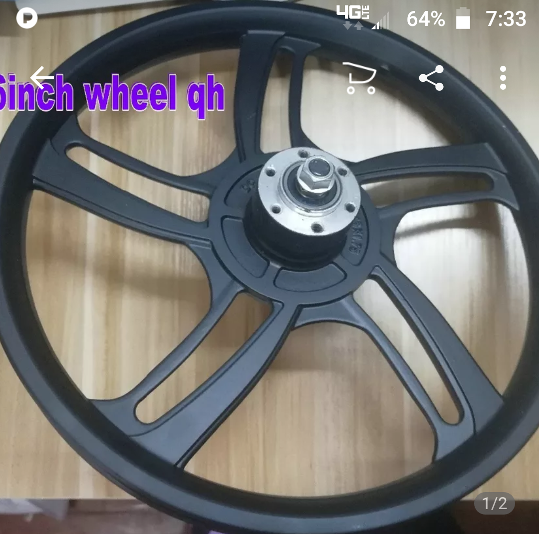

Not completely satisfied with our motorcycle wheels, we purchased the wheels Steve Archer had discovered. They are solid aluminum and have more consistent run out than the motorcycle wheels. They mount a standard bicycle disc brake.
Since Steve only had two wheels, I did a Google image search and found more for sale: https://www.aliexpress.com/item/33014018955.html
They ship with a 30 MM OD and a 10 MM ID bearing. Steve kindly pointed to where he found 30 MM OD 1/2 inch ID bearings: https://rover.ebay.com/rover/0/0/0?mpre=https%3A%2F%2Fwww.ebay.com%2Fulk%2Fitm%2F142904371709
So at a cost of around $66 per wheel, they are cheaper than any other option. They are about half a pound lighter than the modified motorcycle rims but heavier than the plastic rims.
We ran them tubeless at 70 psi at the first race of the season at HCC and had zero problems. The track had just been resealed so there was not much grip or tire wear, so it was not a very stressful test. I will post more as we get more experience with them.

We have run the aluminium wheels at three other races. On smooth tracks, they are great. This includes running the 20 minute races on a 1/4 mile oval running track. The lateral G`s were around 1.7 most of the way around the corners with about 5 degrees of negative camber on the outside wheel.
I do have concerns on rougher tracks. We ran on an airport runway that has lots of divots and holes. When I checked the car after the race, I discovered a crack in one of the spokes on the right front. We are running tubeless 100 psi Hookworm and a solid suspension, so there was a lot of stress on the wheel.
It could just be a flaw in one of the wheels. When I get a chance, I will weld it and see if it is still usable.
The wheel saga continues. My rear wheel broke 4 out of 5 spokes during testing. This was the same wheel that I ran on the rear on the Lee County but I inspected it carefully after discovering the broken front wheel and did not find any sign of cracks. On the other hand, the metal is covered by a flat black paint that might hide beginning cracks.
My test track is very tight and we see higher side loads than are normal in most electrathon races. I ran my spare wheels at the last race and the tire wore out without any problem with the wheel.
We tried welding the first wheel but the aluminum casting did not respond well. We ended up with a bit of a blob and the wheel well out of true.
It turns out they also have a six spoke model. The spokes look slightly thinner but a simpler design. I have ordered a set to try.
