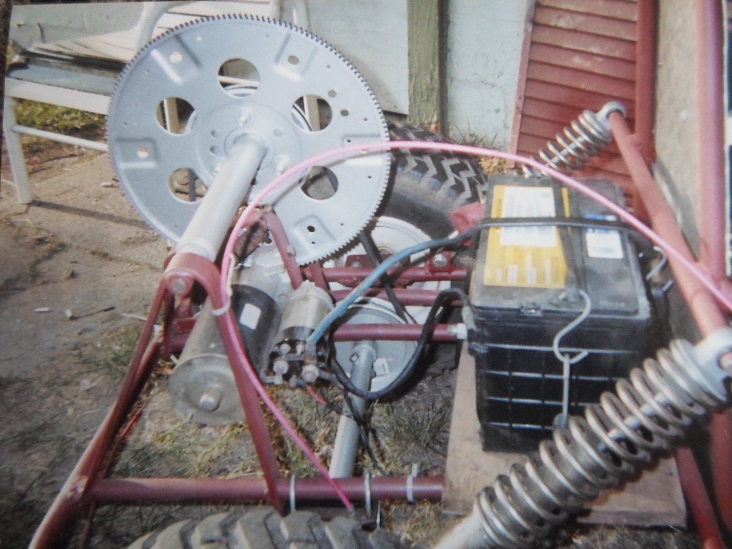

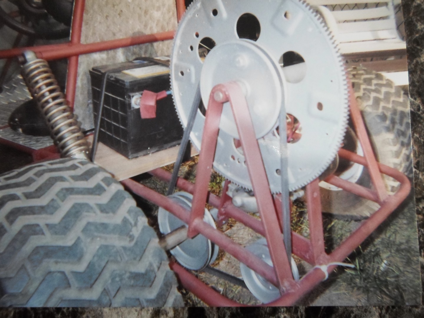

* Here are some pics of the first mini-electric-vehicle that I designed & built (~20 years ago)
It was powered by a used 12V automotive starter battery
...was motivated by a V8 Chevy car starter motor & flywheel
...connected via a belt drive
...actuated by a manual clutch
So, you had to engage the clutch
...then, start the motor, using a standard household light switch (I know way out of spec)
...& then, release the clutch to go
It was very loud, super slow & only lasted about 2 city blocks
