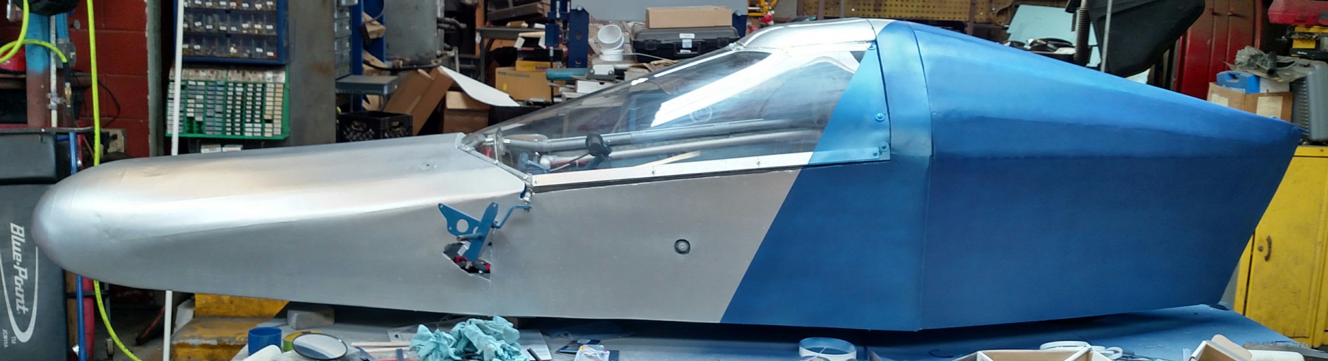

My car started life as a Blue Sky Aerocoupe which I have heavily modified. It's pretty much unrecognizable now I think.
I did keep the dual lever steering and the front spindle setup however. I have always thought the steering seemed heavy and requires a lot of effort. I measured the angle of the spindle today and discovered that it is running a 30 degree caster angle which explains the high-effort steering.
Is this standard for an Aerocoupe kit?
What kind of caster angles is everyone else using?
