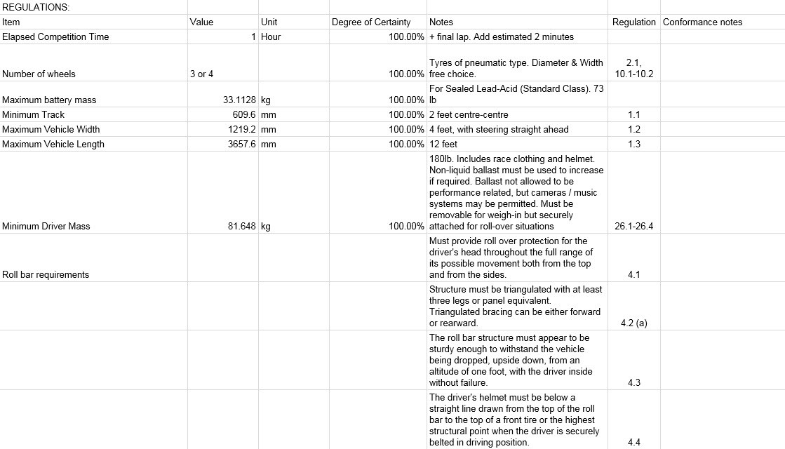

Archer's idea has high merit and was my first thought.
I'd suggest a dot-point / checklist format for all of the rules, with tickboxes for each rule and a small area to describe any non-conformity, would mandate the team to ensure they comply prior to arrival at each event (you could mandate that the teams check for compliance and complete their side of the sheet before arriving at scrutineering). I'd place it as the final sheet in the EA rules, so that it's a cakewalk to find it.
The scrutineer/s then check the team-completed list for any deviation found, re-check and record any discrepancy, and pass / fail the car with comments. With phone technology being what it is these days, then suggest taking a photo of the accepted sheet so that EA have a record of agreed outcomes for the next event for each car.
I've commenced something similar as I try to align my new design to EA rules; here's a small snapshot of it.
