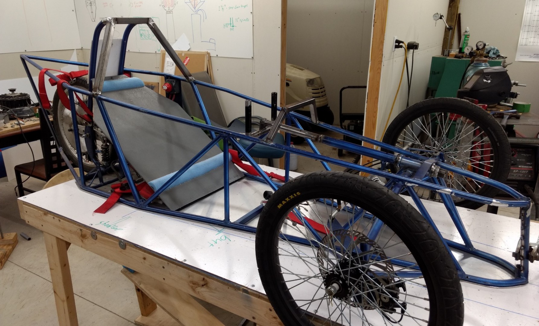

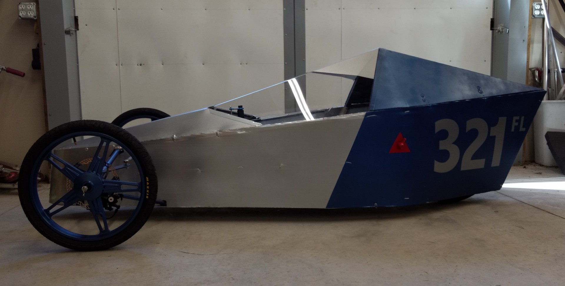

After three years and only 10 races it is time to retire the old 321 car in favor of something lighter, smaller, and hopefully more comfortable. This one measures at 8 ft long (which is over 2ft shorter than the old car) and will have full suspension. Fitting everything inside such a small package may prove a challenge especially as I intend to stick with lead acid batteries. (Although the Open Class is getting kinda lonely in this part of the world as Advanced Battery takes off)

I forgot to report that I test drove around my neighborhood and the suspension makes a huge difference. I don't have to cringe at every little irregularity in the asphalt. 1" of suspension travel is a game changer.

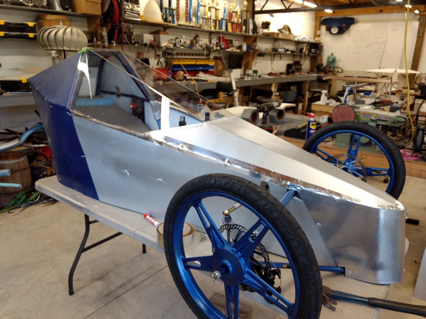

So after one season (4 races) with the new car, I decided I wanted to enclose it. It performed pretty well and I finished in the top 3 in all of my races but I think there's something to be gained aerodynamically. That, and I never liked the look of the original roll bar.
I decided to lower the steering yoke, raise the front cowl height, and narrow the roll bar...
Then it was just a matter of making new coroplast body panels and bendi
the plexiglass for the windshield.
Just gotta finish up the windshield mounting hardware and it's back in action. I'm planning on taking it to the Daytona event next month.
looks good! id be interested to see how it turns out with a body

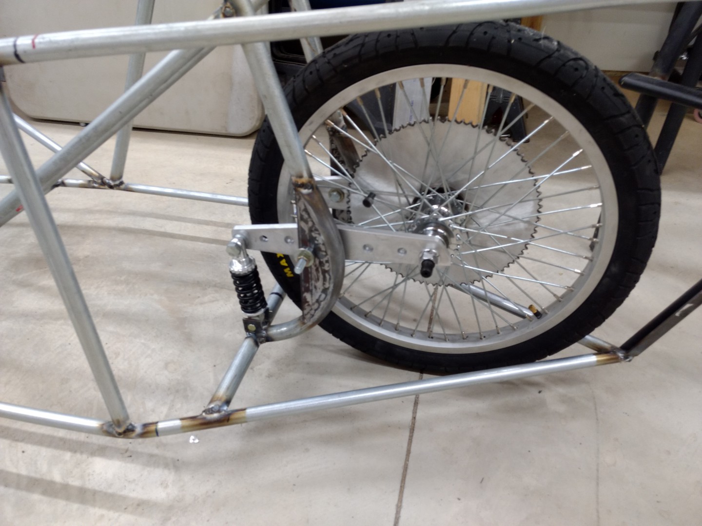

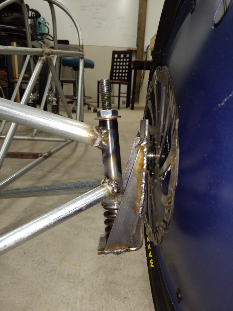

Got my suspension on.
Using a sliding pillar style on the front and a more traditional
swing arm on the rear. It's only about an inch of travel but
hopefully enough to keep me from feeling beat up at the end of the race

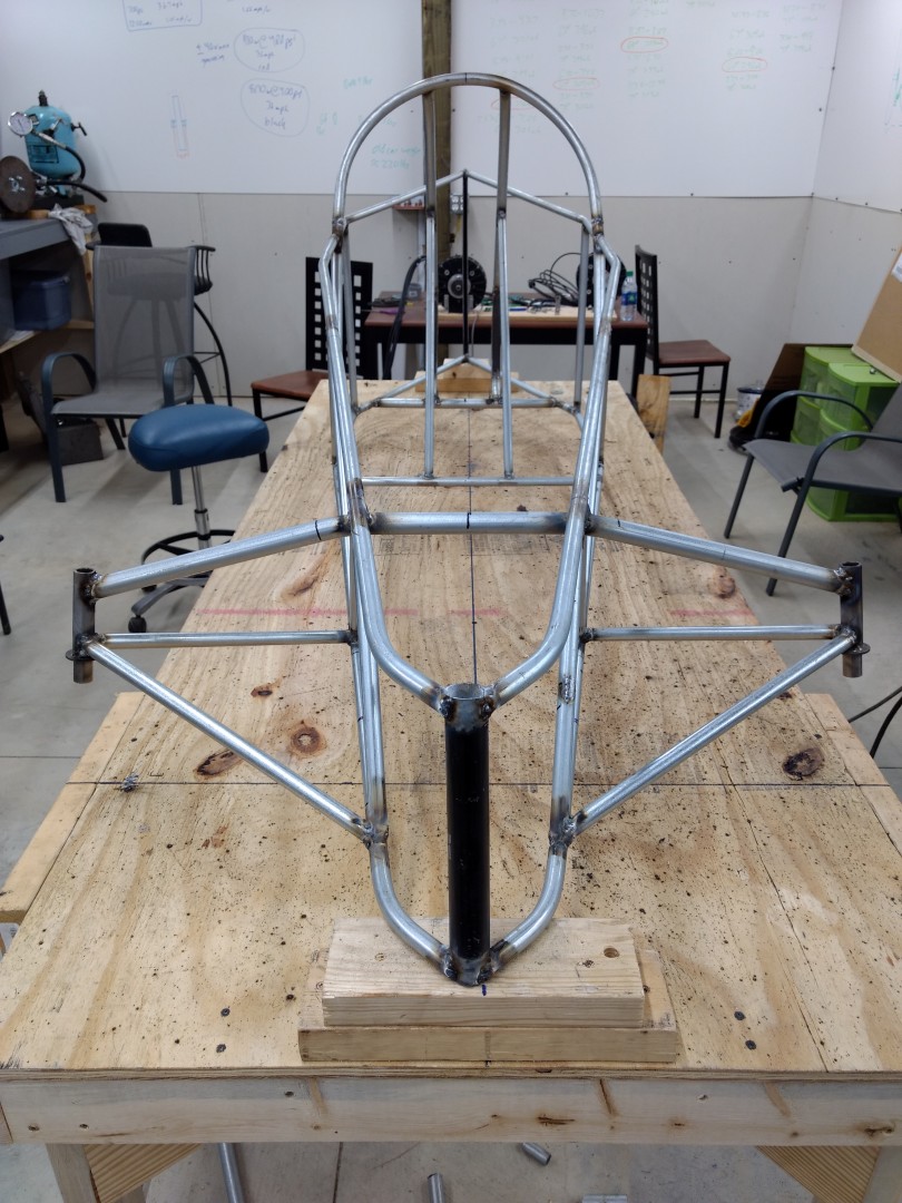

Progress is still being made...
I'm unsure if I'm going to fully enclose it like my last one.
Building a body is a lot of work and I question it's aerodynamic benefit at a max of 40 mph.

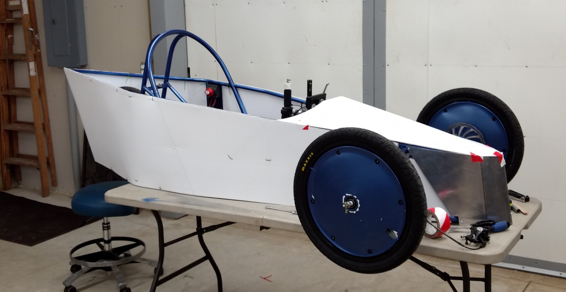

Coroplast panels
Well, there it is.
Slap some numbers on it and take it racing.
It looks a bit like a Robinson clone to me...
Not what I was intending, but there ya go.

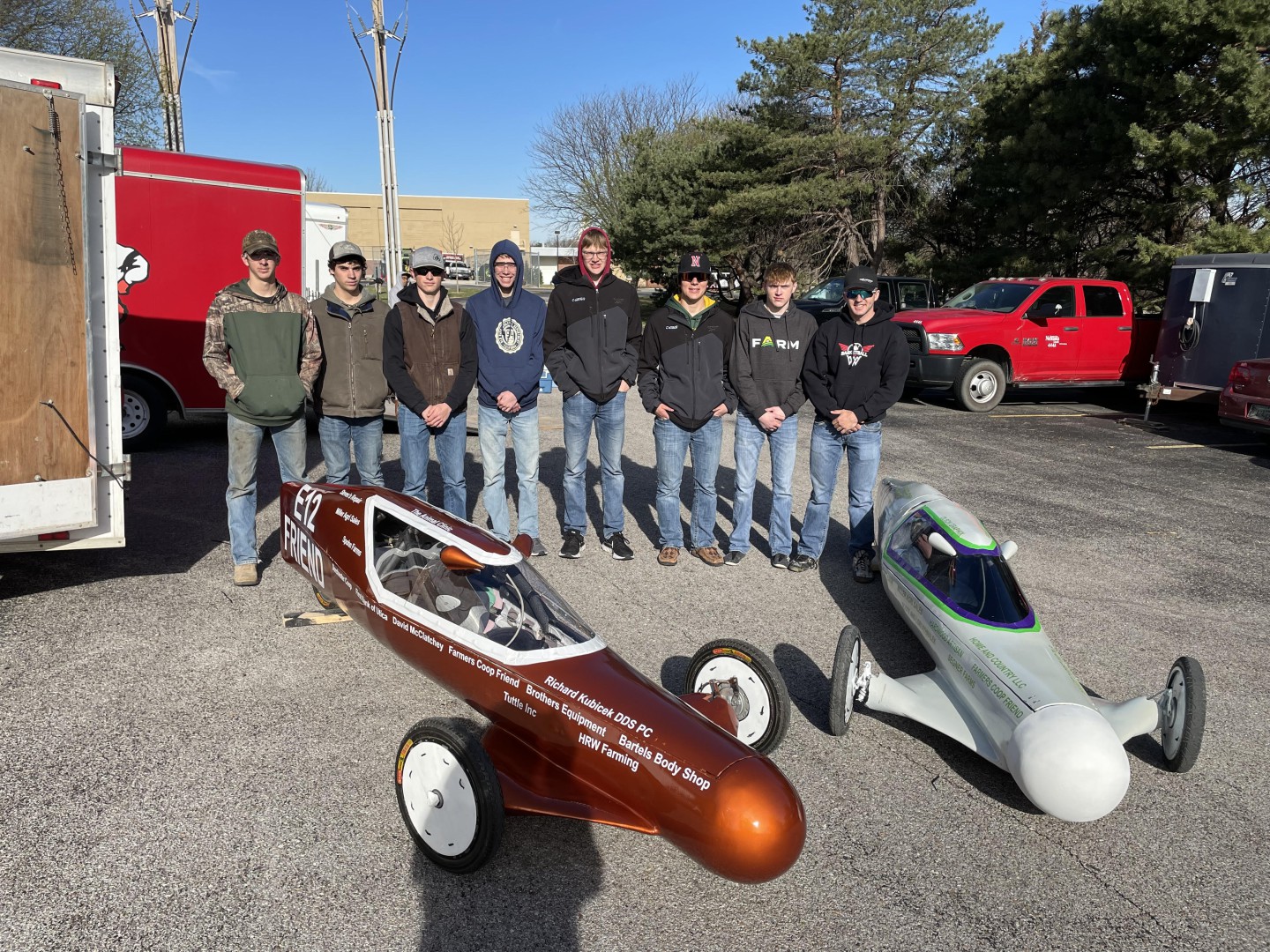

Here is a pic of Friend, Ne 2021 Car.
Friend Ne 2022 Electric Cars and Team
Hi Jay,
These look like great vehicles. I would suggest you start a new topic and post the pictures again. What motor, controller and batteries are you running? Where do you race?
Hope to hear more,
Cliff
We are a small high school in Friend, NE racing in Nebraska. Altrax controller, ETEk motor, yellow top batteries.
