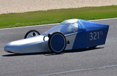

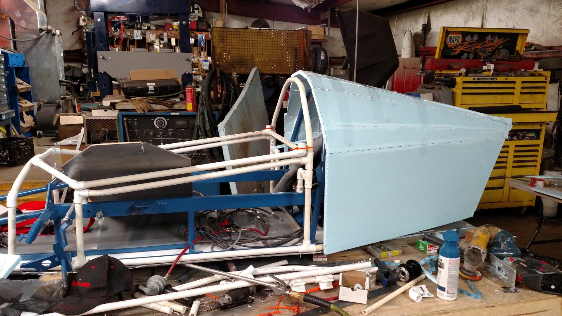

My first car had a styrofoam body made out of 1/2" blue insulation from Lowe's. I formed it over a schedule 20 PVC frame and glued it together with white gorilla glue. In order to make it more durable and to take paint, I coated it with Styrospray 1000 which is a difficult to obtain industrial coating.
The body was very light and fairly easy to put together, but really wasn't durable at all. The coating would crack and flake off pretty readily. Maybe I should have used more of it... I dunno.
