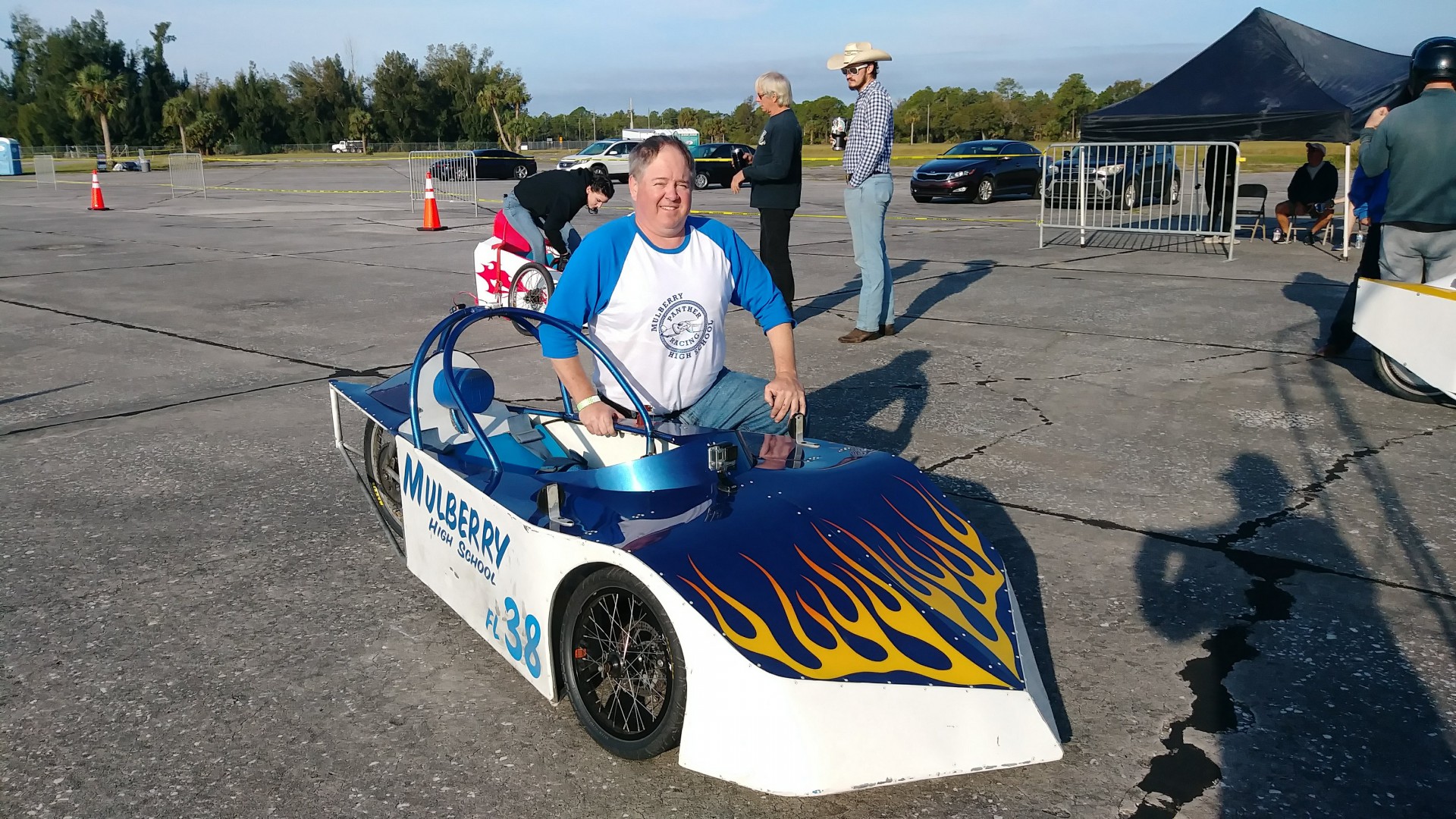

The image attached is me in the car at the Lake County event where we race on a WWII air field. Less turns more go!
