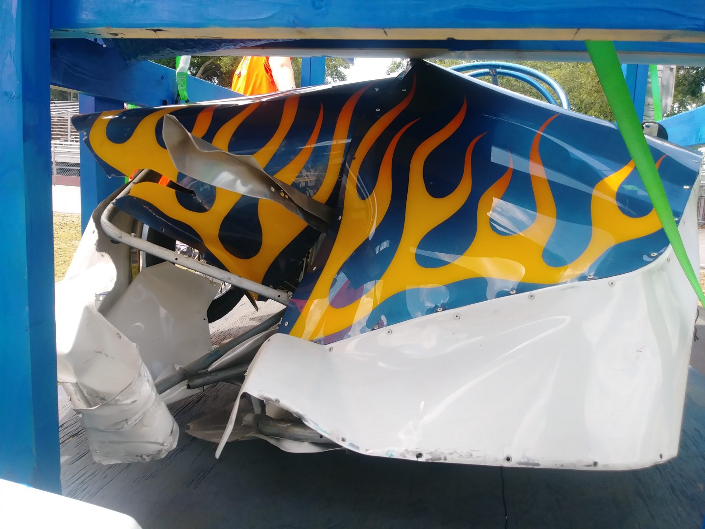

Back in November of 2020 on a parking lot at Plant City High School, a parking lot used almost exclusively for busses to load students, I blew a tire in the last few minutes of an hour long race and skidded across the pavement to a stop into a concrete island. See photo. I slide for 30 or more feet before I came to a stop after blowing the tire. I should have taken this as a wake up call.

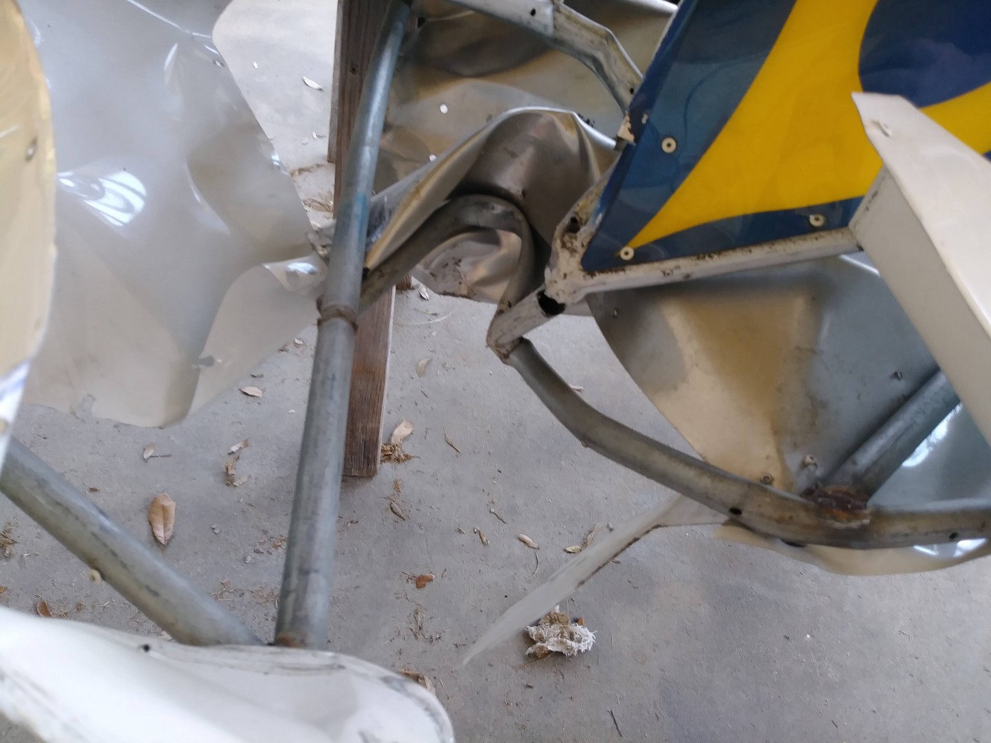

In April of 2021, at Brandon High School on a 0.25 mile jogging track, I blew the right front tire at about 30 mph. This put me and my car into the fence. Like a weight on the end of a string when the string breaks, I went off on a tangent and continued straight into the barrier. You can see the moment of impact from the GoPro, the images showing the damage to the car, and the bruise on the inside of my foot where I believe the pole and foot collided.
Why did this happen? I discovered that when my tire blew in both instances, I lose steering and the ability to stop with my two front disc brakes.

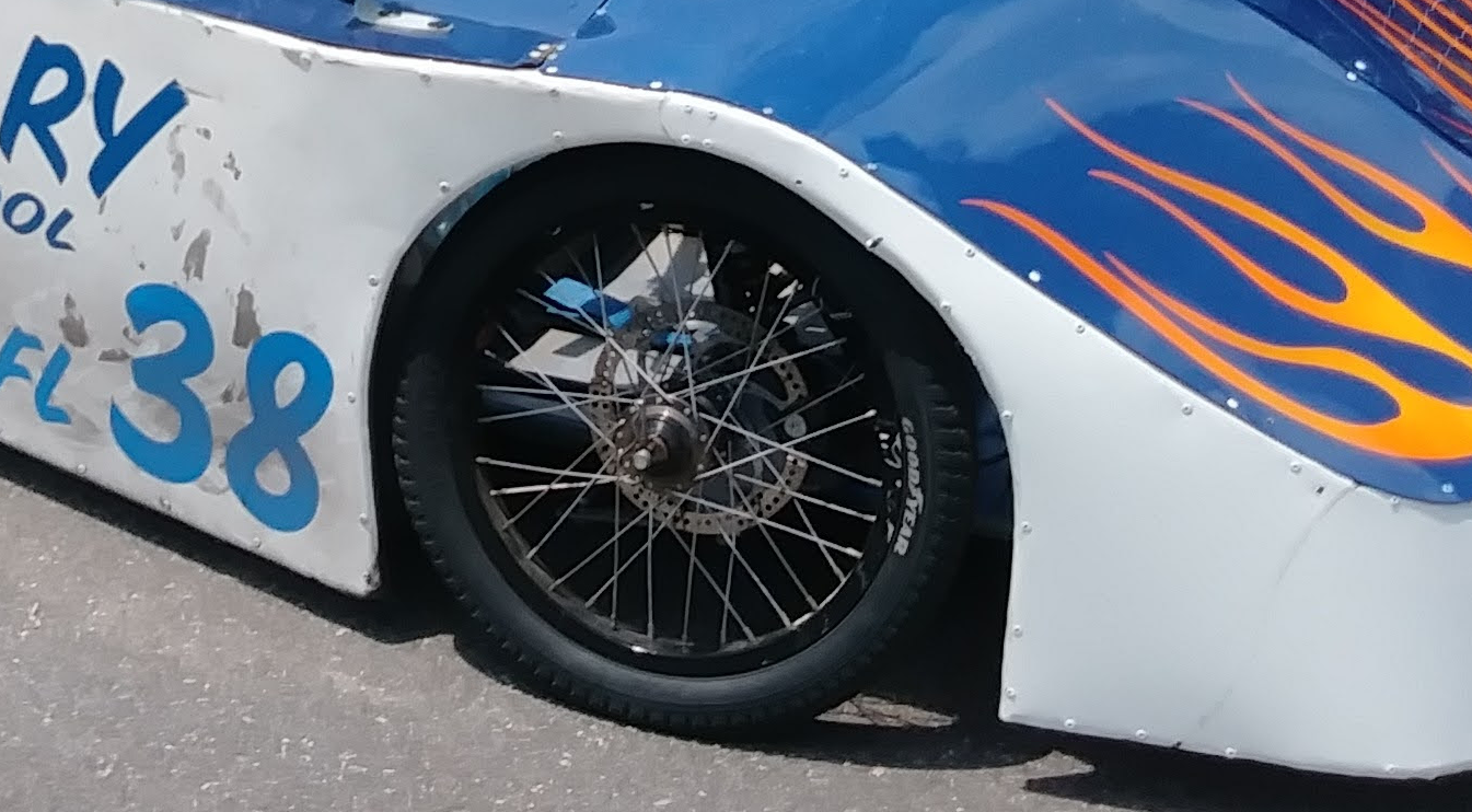

In the rule book, page 8, under 10 - Wheels and Tires point #3 states: "The minimum ground clearance is to be judged by the cars ability to roll over a 2x2 that is milled to be 1˝ x 1˝. This is to prevent the vehicle from sliding on the ground in the event of failure of any or all of the tires."
My car complies with this. My car clears a 1 1/2" obstruction without issue. However, with 1.75 tires on my car, when the tire blows, the car is now about 0.25" below the rim of the wheel.

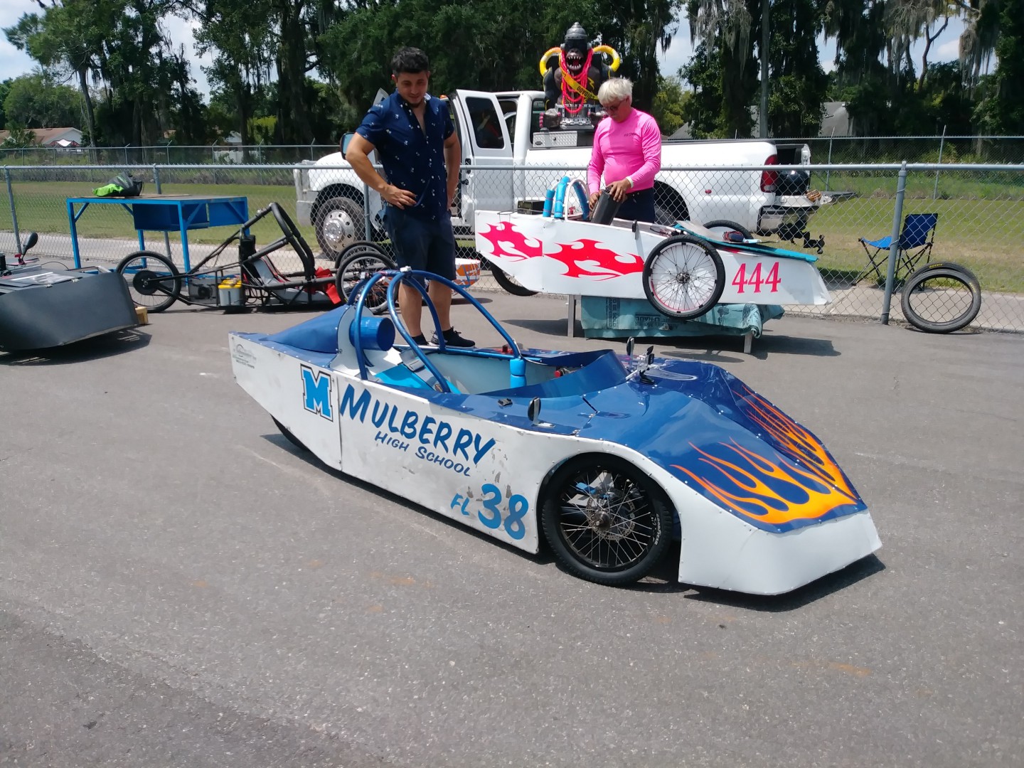

Here's an image of my car from the side. This is after the repairs where the nose was brought up slightly. But still, as you draw a line from the back of the wheel well to the front of the wheel well, the rim appears to be higher than the lowest part of the car. As a result, a blown tire lays the car down on the smooth underside with only the rivets to slow me down. :)
I will say the this past weekend, I raced the car in the final race of the season and blew two tires. The first tire blew about 30 minutes into the race and was on the inside of the track. I had control the entire time and was able to steer into the infield and brake to a complete stop. I was able to swap wheels and get back out to finish the race only to have the other tire, right-front wheel this time blow. Again, I had control, steered into the infield and brought the car to a stop (once I let go of the deadman switch).
I believe what is needed is a rule that states the rim of any wheel must be lower the lowest part of the vehicle. My wheels are 16" up front and 20" in the back at the drive wheel. I run a reverse trike or cycle car design. One of the reason for the blown tires is that I used to use Maxxis Hookworms exclusively. They no longer manufacture these in 16" and I have been force to move to Big Blue Box Store kiddie tires. The last race I ran with GoodYear Tires heavy duty tire and tubes (brand new) and they still failed. Oh, and the fact that I weight 40 lbs over minimum driver weight might have something to do with it.

I would like to start a conversation about updating the ground clearance rule in the rules. But, first, allow me to share my experience to illustrate the contradiction in the rule book.
