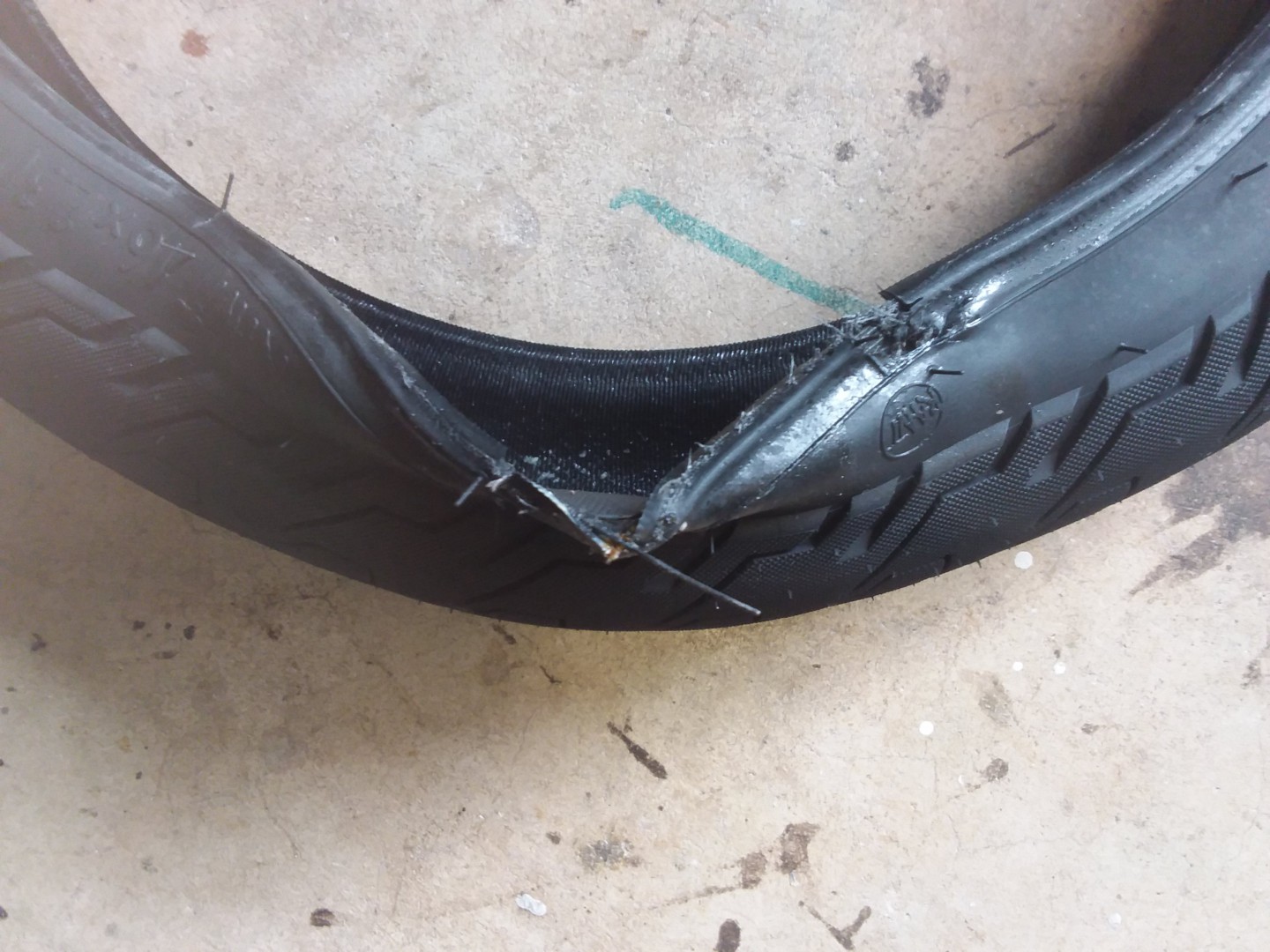

By the second race, it was getting really hot. The stickem on the back of our Velcro pieces were turning into liquid and falling off. I normally run these tires tubeless at 105 psi. Last time we ran here, we were running the tires at 100 PSI. As a concession to the heat, we decided to run at 80 psi. Of course, the tires have a rated maximum of 60 psi. The first 35 minutes went fine. Then...
A rear tire swap got me back on the track. My pit crew put on the used rear tire from the first race. It did not have that much tread left. By the last couple of laps, I was down to the belt and the tire was going flat. I had to use the biggest arc to get around the corners to avoid unseating the tire and drive in the middle of the track to allow for my lurches right and left. Luckily, drivers trying to repass me, were alert and managed to avoid my wanderings (though I understand this required at least one off track excursion).
Of interest to anyone running Rant Squad tires in high heat, we had a second tire fail during the race. This was a spare front tire sitting in the sun in the back of the rescue truck. Both tires failed in the same way, at the same point. It looks to me like the wire bead is not attached to itself but held by the rubber of the bead. When it gets to hot and there is pressure, the wire comes loose from the tire and the side wall rips.
https://www.youtube.com/watch?v=dWQ9BUuQLIs&pp=sAQA
Race tire:
Spare tire :
