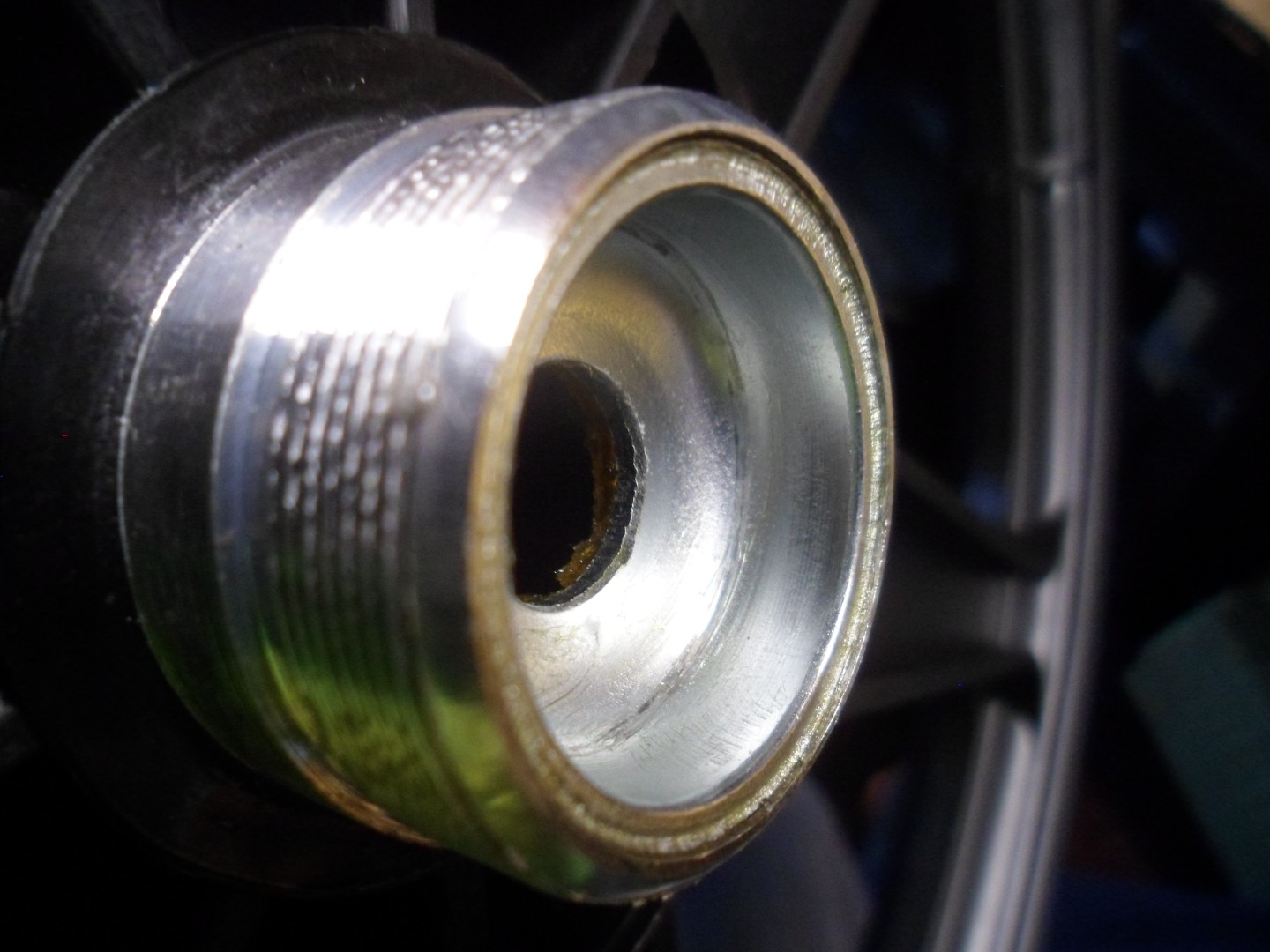

The rear rim, that I have, has threads on the outside of one side of the hub, for attaching a freewheel unit
I've noticed that some large diameter (like 26") front wheels also have outside threaded hubs with an adapter threaded on & a rotor bolt to it
...but, not any smaller ones (like ~20")

I have a couple of 20" BMX bicycle wheels that has an ~35mm aluminum hub, that protrudes ~1/4" from the rim (on each side)
...& was thinking about (maybe) trying to thread the outside of this hub, to accept an adapter (like mentioned above) that a rotor can be mounted onto
Does anyone think, this will work?
...or has anyone done this?
...or seen this been done before?

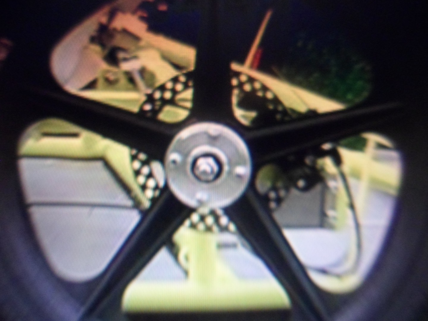

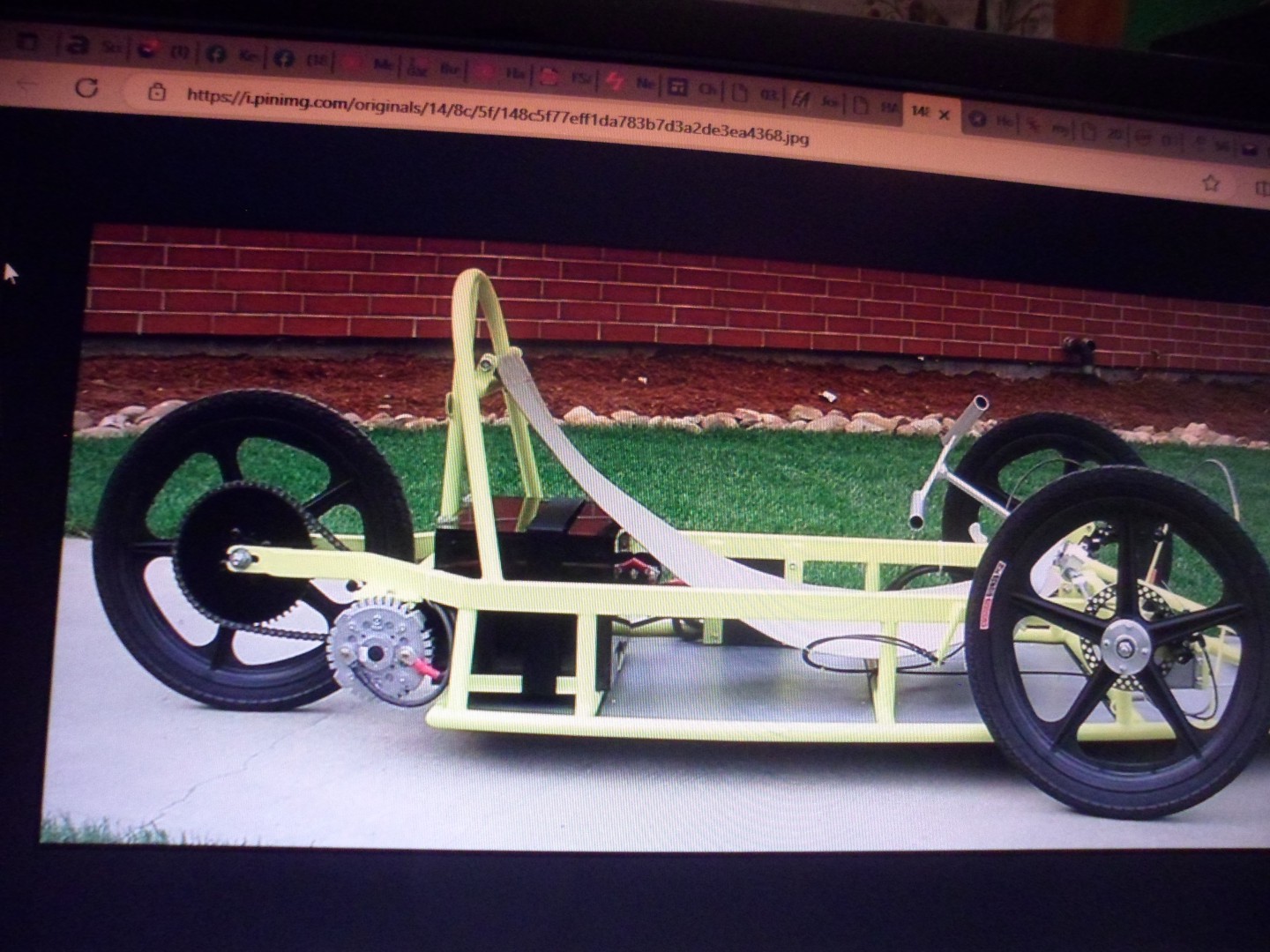

Looking around I came across this kart
Especially the front wheels

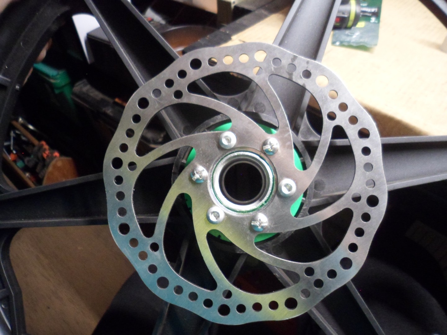

So, I made up some hub rings
...drilled some holes
...& used some Loc-Tite to bond a brake rotor adapter to the BMX bicycle wheel
...& then, ran 3" Stainless Steel
bolts thru the hub rings, rotor & adapter & wheel to increase the strength & durability with a mechanical bond too.

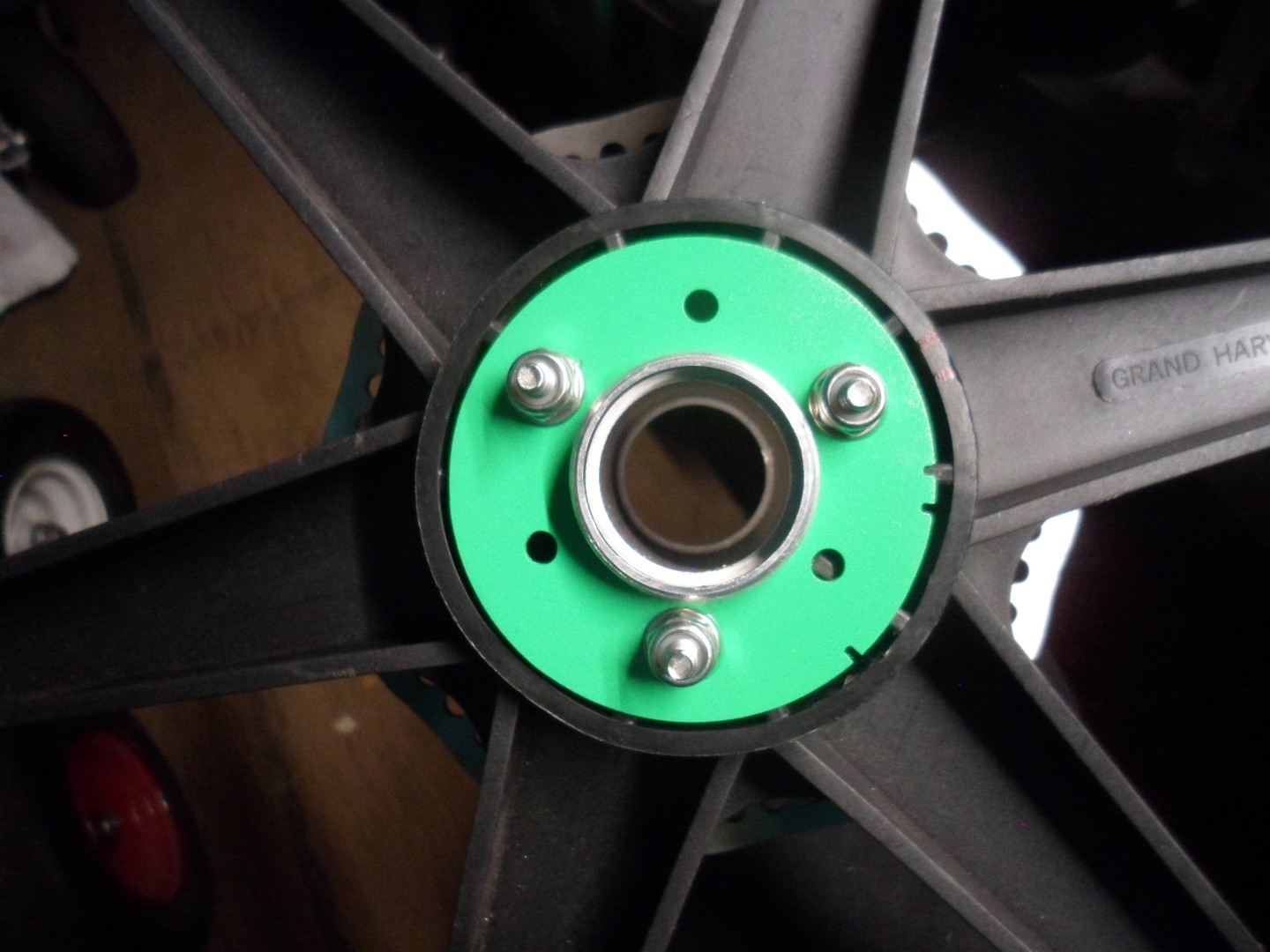

I upgraded the stock bicycle bearings on the front wheels
...with (4) RS8 bearings
These bearings are much higher quality
...& also facilitates the upgrade from the stock 3/8" bicycle axle, up to 1/2" Grade 8 bolts
Some .025 shim material was required for the bearings to fit "snuggly" in the bicycle hubs
...& I used some Loc-Tite bearing retaining compound to "glue" the bearings & shims into the hubs
