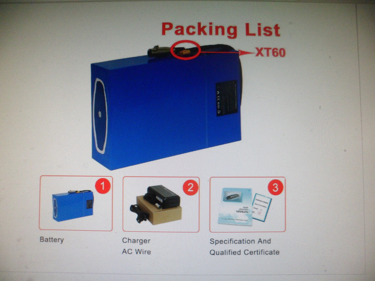

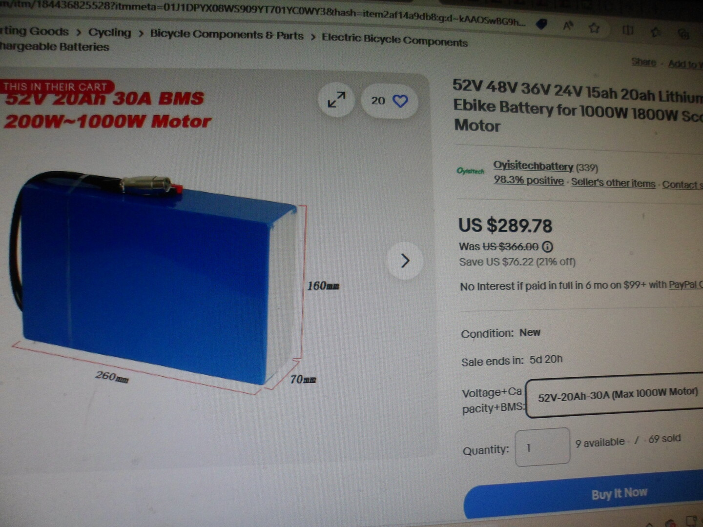

So, to expand on the conversation, here is a link
...& also, some specs (for a couple of examples)
52V 48V 36V 24V 15ah 20ah Lithium Ebike Battery for 1000W 1800W Scooter Motor | eBay
52V 48V 20ah Lithium Ebike Battery for 1000W 1800W Scooter Motor
Here are the specs for a (13S) pack
Here are the specs for a (14S) pack
*Also, states that a specification & qualified certificate comes with each pack

* Notice: The 48V is configured as 13S8P (104 cells) is listed at 840Wh
...& the 52V configured as 14S8P (112 cells) is listed at 1,040Wh
So, would the 1,040 Wh spec be an automatic disqualifier?
...or would that give us maximum energy (being able to use a whole/full 1kWh) while racing
...while still leaving a bit of a "safety" margin?
