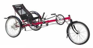

There is also another tricycle steering method that the first Tampa Electrathon car had, dual lever on a tricycle. If you look closely at this picture you can see the steering is the front wheel with levers directly next to the seat

as to the "push pull" steering on a trike... the Dave Cloud cars have been doing that for years... (over a decade)
but of course you might not have seen a "cloud car" being that I think the only one "out east" (that I know of)
is the #420fl car of the PHS electrathon club in florida
